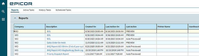

I don’t recall this behavior in E9 and I just happened to notice it while helping someone in Kinetic. But system monitor shows all reports run by ANY user. So my shipping receiving team (and all other users) are able to see P/L, AR, AP, GL, Etc Reports that are printed by others. I know that if your a security manager you can display all reports, but for all other users, I thought they could only see reports they generated. I looked all over for a security checkbox or something to limit the data shown in System monitor to only reports for that user, but couldn’t find it… Am I finally losing it? or did this become expected functionality? I sent a ticket into Epicor as well.

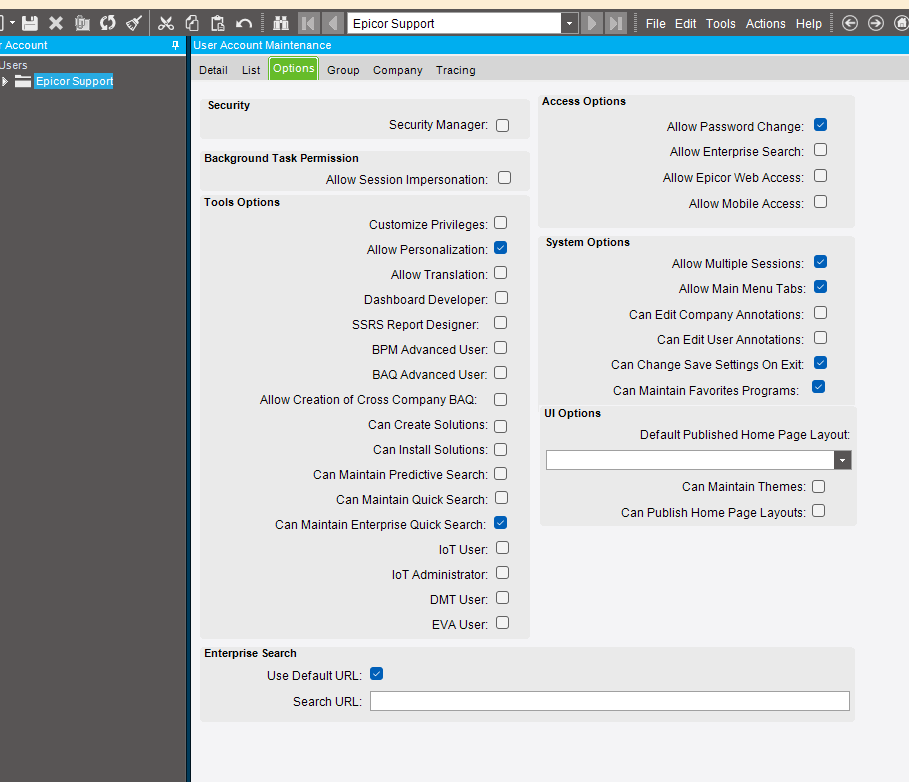

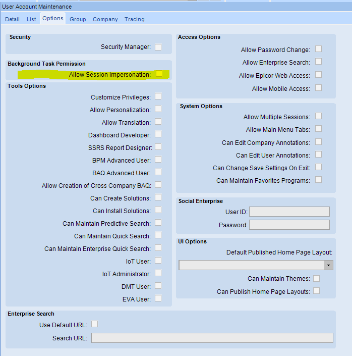

e: Apparently the ‘Allow Session Impersonation’ setting in User Account Maintenance controls this.

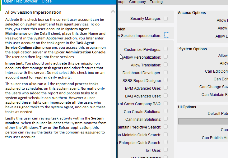

User Account Maintenance-Options Fields
Lastly this user can review task activity within the System Monitor. When this user launches the System Monitor from either the Windows Tray or the Epicor application, this person can review the tasks for the companies assigned to this user account.
@hackaphreaka is corrrect…all users are seeing all tasks!! I’ve always kept All tasks off for myself unless troubleshooting something, but I don’t think all my users should be able to see all tasks.

Why other than service accounts is this enabled for your users? From the help it doesn’t sound like this is a bug but designed as such so the task agent can print as the actual users session.

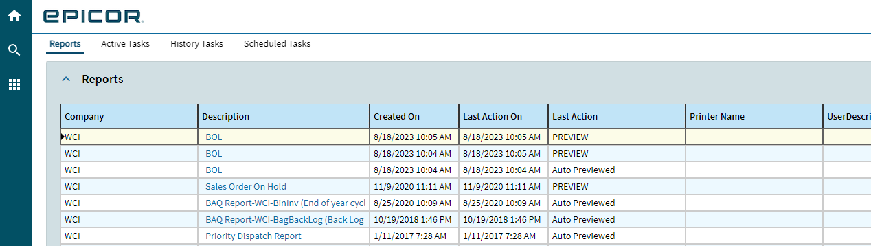

we use the kintetic smart client and users can see all the reports from other users in the “reports” section. I do not have the “allow session impersonation box” checked for any users, Epicor support had asked me to check that as well. They had a Dev task created for it. TASK7265408

Verified that even though a user can see another’s reports that you can also recall the report for preview?
