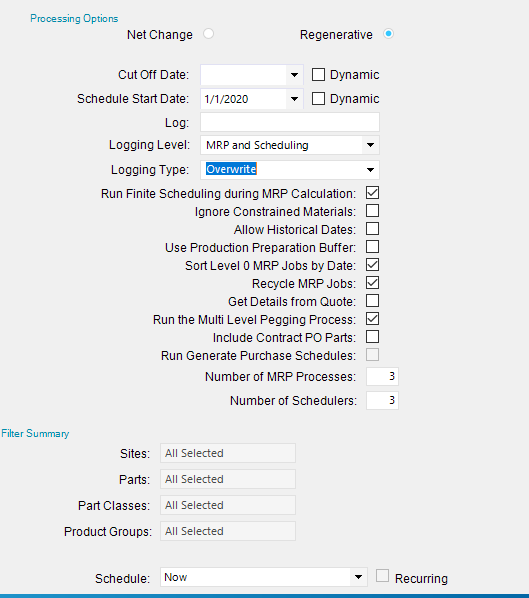

Are you running MRP as Regen or Net Change?
Regen processes everything, Net Change only what was processed previously + where the PartPlant.MRPRecalNeeded = True.

Outside of that you should generate Logs during your MRP Process where the Logging Level is at least ‘MRP.’

Do you have full MRP logging during your MRP run? If yes, you can look in your log files and see if it tries to create, then deletes the job. Usually it will tell you why it is deleting a job it just created.
Matt,
This is how we run it every night. Would I just name the Log: ? then run it ?
Any name will do. Ie: NetChange, or Regen, or if you run manually, you might want to give it a different name each time so you can go back to old logs. Also, I hate recycle jobs. There have been way too many issues with recycle jobs for a long time. I see that you are hosted, so I am not sure if you have access to your log files.

Have you been able to look at the MRP logs? There is so much good information there. MRP might actually be creating the job, but because of some other issue, the job just gets deleted.
A regen log would be best because you start fresh and you will know for sure.
