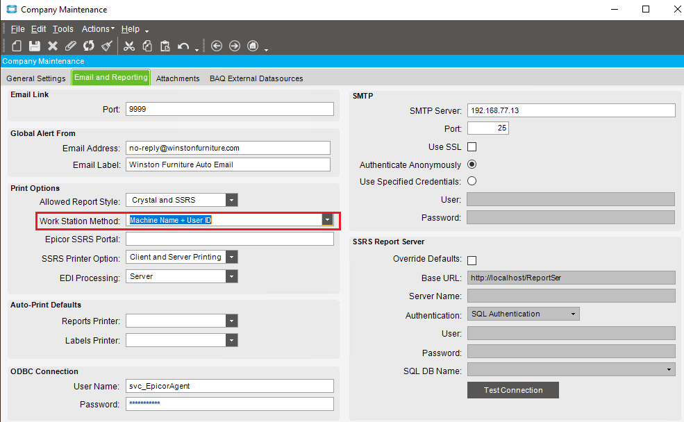

The problem has been solved:
Workstation Method can’t be **Default. **
This seems to be an issue with 10.1.600.x
