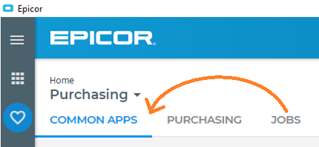

Before I put in an “idea” request for this, there is no way to re-order the tabs in the kinetic/active home page, right?
Like in the pic below, is there a way to put the “JOBS” tab before the “PURCHASING” tab?
There isn’t in 10.2.400. Not sure if they’ve added it in 10.2.500 or 10.2.600. Would be a nice feature.
The only way I can see in 10.2.600.3 is to delete the tab(s) and add them in the order you want.
That’s the only way I know how to adjust the layout in 10.2.400.
@chaddb I looked at the 10.2.600 demo database and I don’t see a way.
@tsmith Right, not my favorite idea. You can move things from one tab to another, but still it’s no fun.
OK thank you gents. I will submit it.
Drop the link here so we can vote for it. Would save a lot of time to just add a reorder option.
https://epicor-manufacturing.ideas.aha.io/ideas/ERP-I-327
