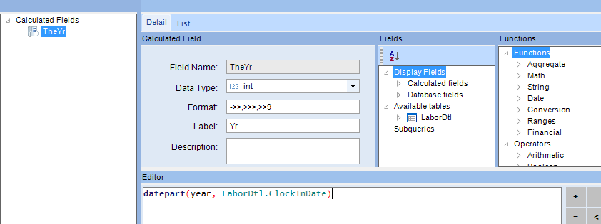

There are probably a lot of ways to do this but you could first add a calculated field to your query that returns the year from ClockInDate:

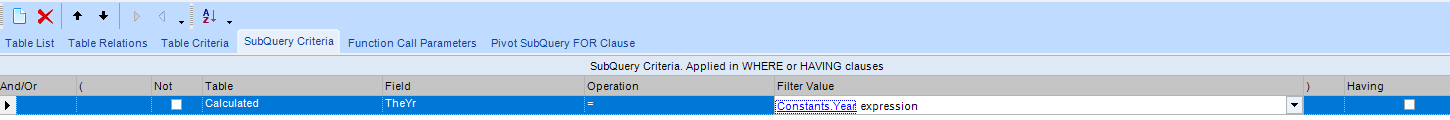

There is also a BAQ constant that returns the current year, so you can then add a Subquery Criteria that compares the value of your calculated field to the constant value and return rows where they match:
