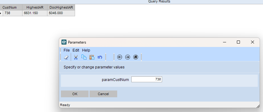

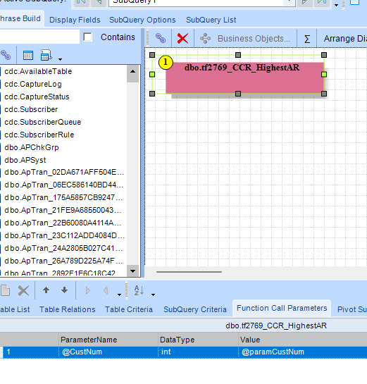

I have an external BAQ that uses a table function with parameter. It works fine using the External BAQ program, however it doesn’t work when I call this EBAQ using code.
I get the following error:
Parameter ‘paramCustNum’ is configured as mandatory but no value is specified
Even tho I add the parameter and its value inside the “ExecutionParameter” table:
