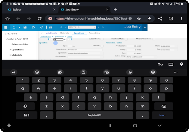

How well is the Web UI working for that? Specifically with the On-Screen Keyboard. I opened up the Web UI on my Galaxy 5 Fold and the keyboard takes up well over half of the screen.
Is that something that your end users have issue with? Or did you go a different route and utilize wireless keyboards and such?

Ah yes…the classic web UI. I’m surprised it even loads for you :laughing:
We are using EKW
Using desktop Kinetic without a physical keyboard is a nonstarter. Even though it is now browser based and can function on anything with a screen, the input method is still based around fingers on keys, and the soft keyboard doesn’t cut it.
