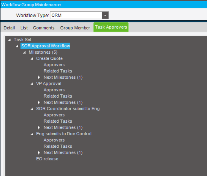

Thank you Ernie. I created a workflow group and associated it with the task set I created but it still seems to be doing the same thing. I see a drop down menu for “approvers” under each task in the workflow group maintenance module but it’s not populated with anything. I’ve added 5 group members with the role code associated with the task, but I’m still getting the same thing - when the primary salesperson completes the first task, it auto-defaults back to them, and the other group members are unable to complete the next task in the sequence.

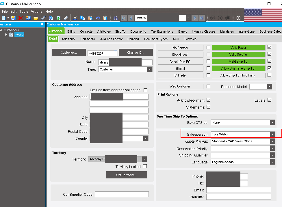

Instead of creating a new thread, was there a solution to this? i know its over a year old. i am trying to use the task for our quoting process but the customer salesperson attached to the customer is the person that every task is assigned to even though i have different people in the workforces attached to the different roles. Is there something i am missing or was this bug never fixed?

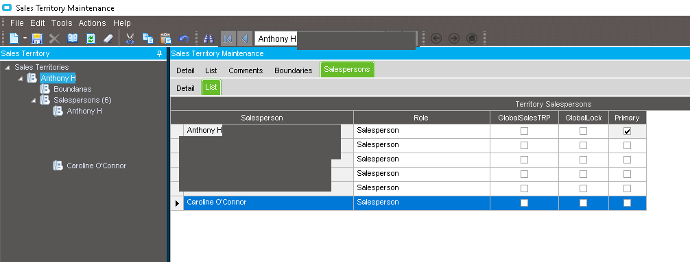

FYI for anyone in the future. The person in the role for that task has to be added under the territory sales person with the role code for the task. If the role for the task does not exist in the territory then the customers default rep will be the default person the task is assigned to.

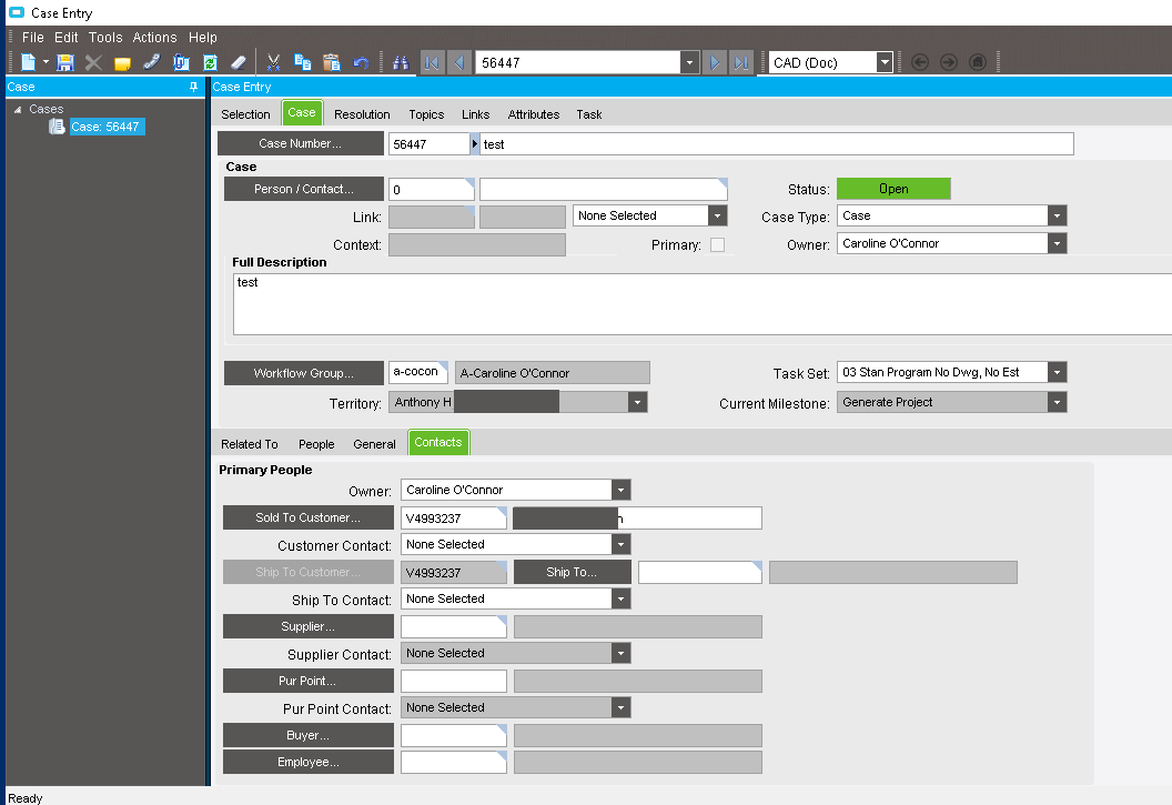

We upgraded from 10.2.200.28 to 10.2.500.19 this week and are into a similar issue for Case tasks. It seems to be ignoring the workflow group definition now and assign any “Salesperson” role task to the Customer’s salesperson workforce. I tried adding the “correct” workforce into the territory (with right role) as Jose proposed, but no change. We also had a data-directive erp.Task.Update BPM that was re-assigning the task in some special occasions but Epicor seems to be overriding whoever the BPM tries to choose (In-Pro or Std).

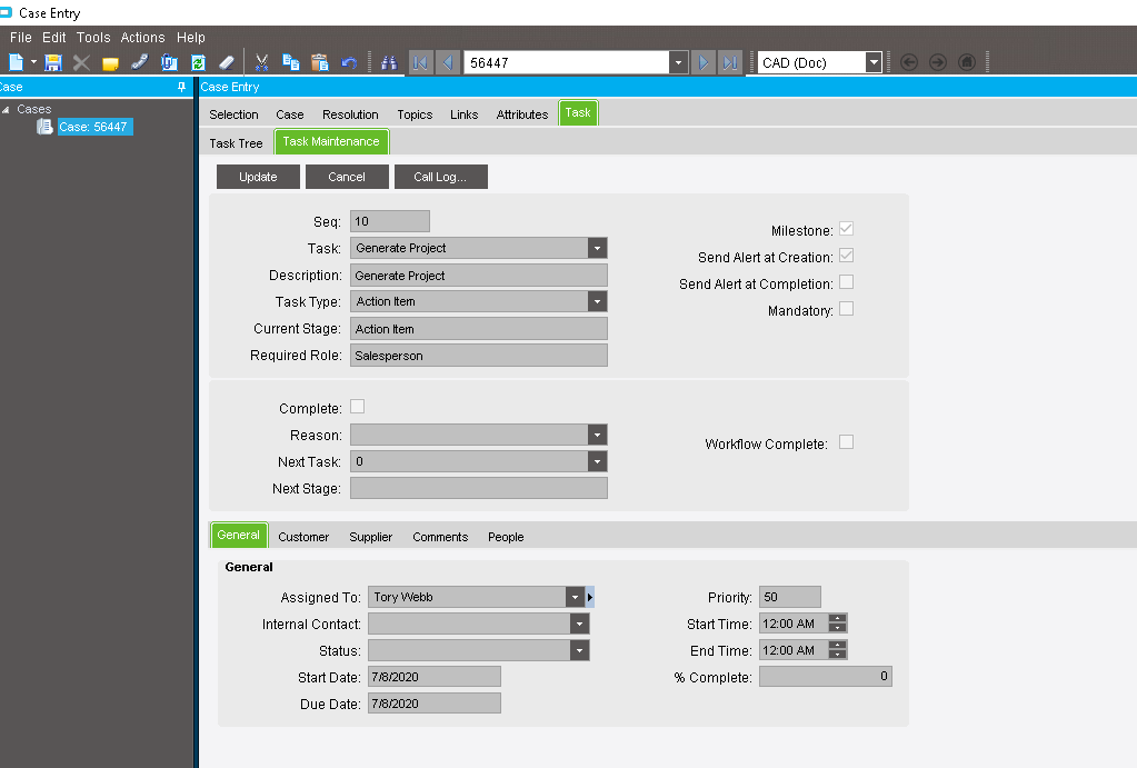

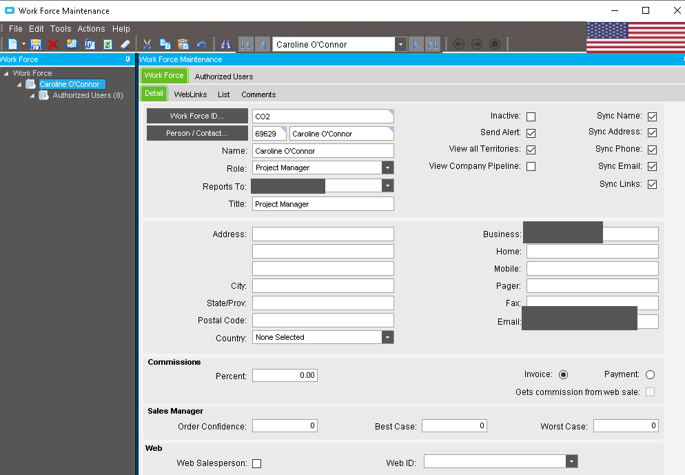

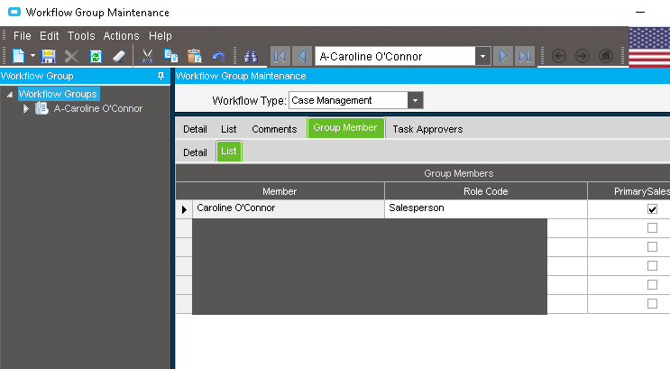

So you have the role in the workforce screen with the correct role? Can you send some screenshots of your setup? task setup, workforce setup etc.
Thanks for responding. Please let me know if missing anything. Im not sure how confidential the data is so I tried hiding what doesnt seem relevant.

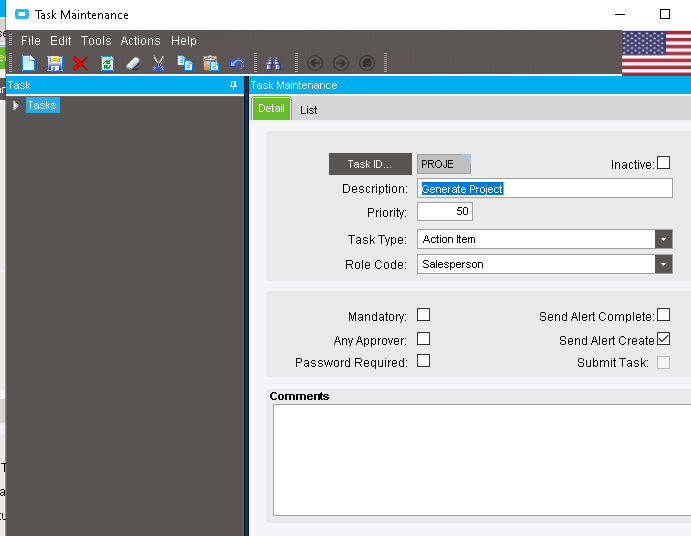

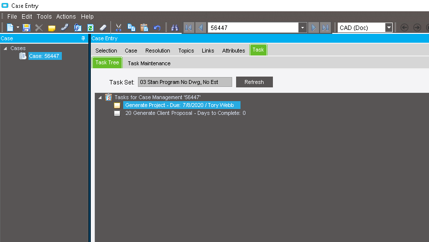

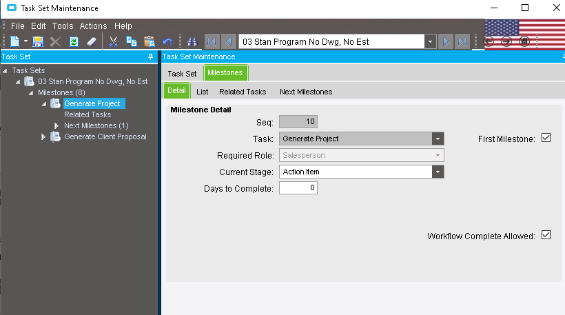

Where re your task setup? everything looks good on the screenshots
Sorry for delay. Here it is
