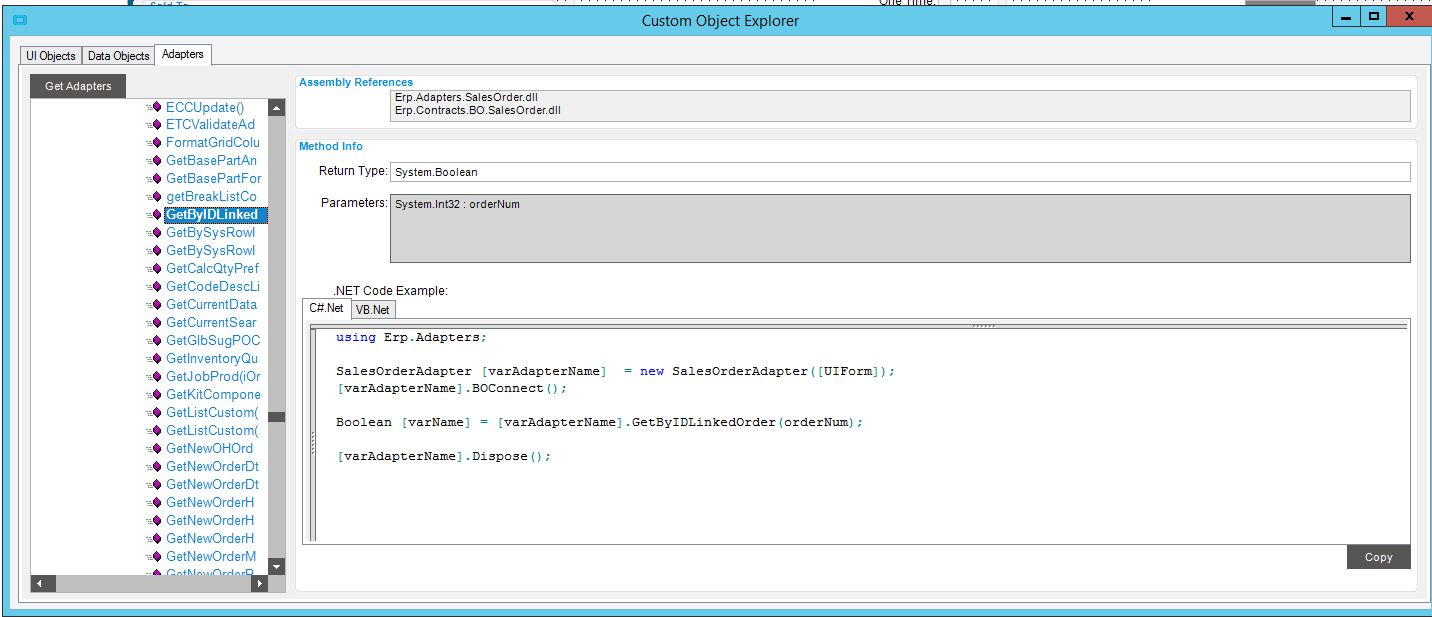

You can also utilize the object explorer in customization mode to find any method you need and the required params.
