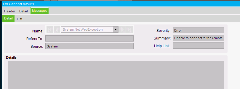

I have a user that gets an odd error via TaxConnect.
After calculating the taxes, and viewing the Tax Connect Results yeilds an incomplete message window (note the blank RefersTo and Details fields):
Recalculating the taxes again often fixes it, sometimes taking more than 1 try.
Is this a connection issue between the App server and Avalera?

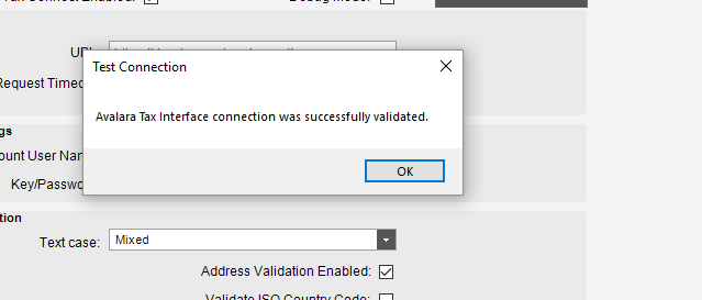

I did the Test Connection in Company Config, and it tests okay.

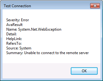

I just ran the Test Connection again and got (after about a minute of waiting):
Checked with https://status.avalara.com/ , and they report no issues.
Anything on my side of the firewall to check?

No generic internet issues (that I see).
The results of running the connection test shows the failures are intermittent.
I’m located remotely from the servers and use RDC to connect to them (through the internet, not our LAN). I’v had no issues with the RDC connection.
Just got 2 failures, then 2 successes, then another failure.
josecgomez
(Jose C Gomez)
November 21, 2018, 3:27pm
5
Looks like you have a node somewhere in your path between you and them that is dropping stuff…
Run a ping -t avalaraIPAddress > file.txt for like 10 minutes
and see what your dropped packet rate is.

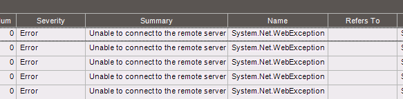

The internal messages is what had me looking at this in the first place. They provide no more details than:
