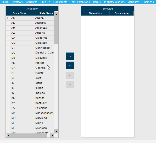

Your customers will sync to avalara when you process transactions. You can manually add tax exemptions for each customer in the avalara website or buy cert capture. Epicor doesn’t show you which states the customers have an active exemption for in Avalara.
We added a UD screen to customer to show the states where exemptions are setup. This was manual, but now it’s automated via the avalara api.

So you register exception certificates in Avalara to allow customers to not get charged tax. We wanted a way in Epicor to know if a customer had an exception and for which state.
So we used the Avalara API and the Epicor REST API to feed the exception certificates into Epicor from Avalara every day that way Finance can easily see if a customer is setup for an exception in a certain state without having to login to avalara web interface.

All we do is display the cert capture information in customer tracker
It isn’t a two way sync
