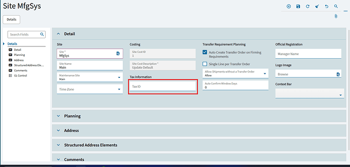

I noticed in Kinetic, there is a Tax ID field on the Site maintenance detail screen similar to the Company level Tax ID field on the company configuration screen. I don’t remember this being in any previous versions.
Does anyone know if these are used in the same manner? Would this essentially give you the ability to not have to create a multi-company set up for locations with different Tax ID’s?
I know the rule of thumb has always been if you have any subsidiaries that are their own legal entity or have their own Tax ID, then you should set them up as their own company inside of Epicor. Our company has multiple subsidiaries that all work exactly the same and share pretty much all the same data. We would essentially like to set them up as sites using this Tax ID code instead of separate companies that then have to share global data.

Which form did you notice the Tax ID, Supplier, Customer?
Thanks! I was definitely missing some supporting info there. I’ve edited the post to hopefully elaborate a bit better on what I was trying to ask.
I am specifically looking at the Site Maintenance Detail screen.
