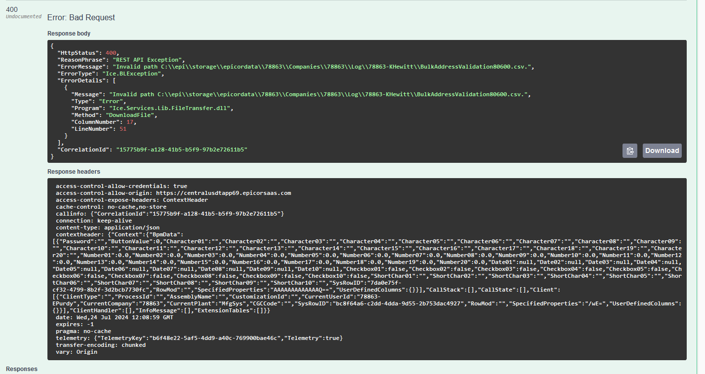

Edit: Its forming the path wrong, missing a \

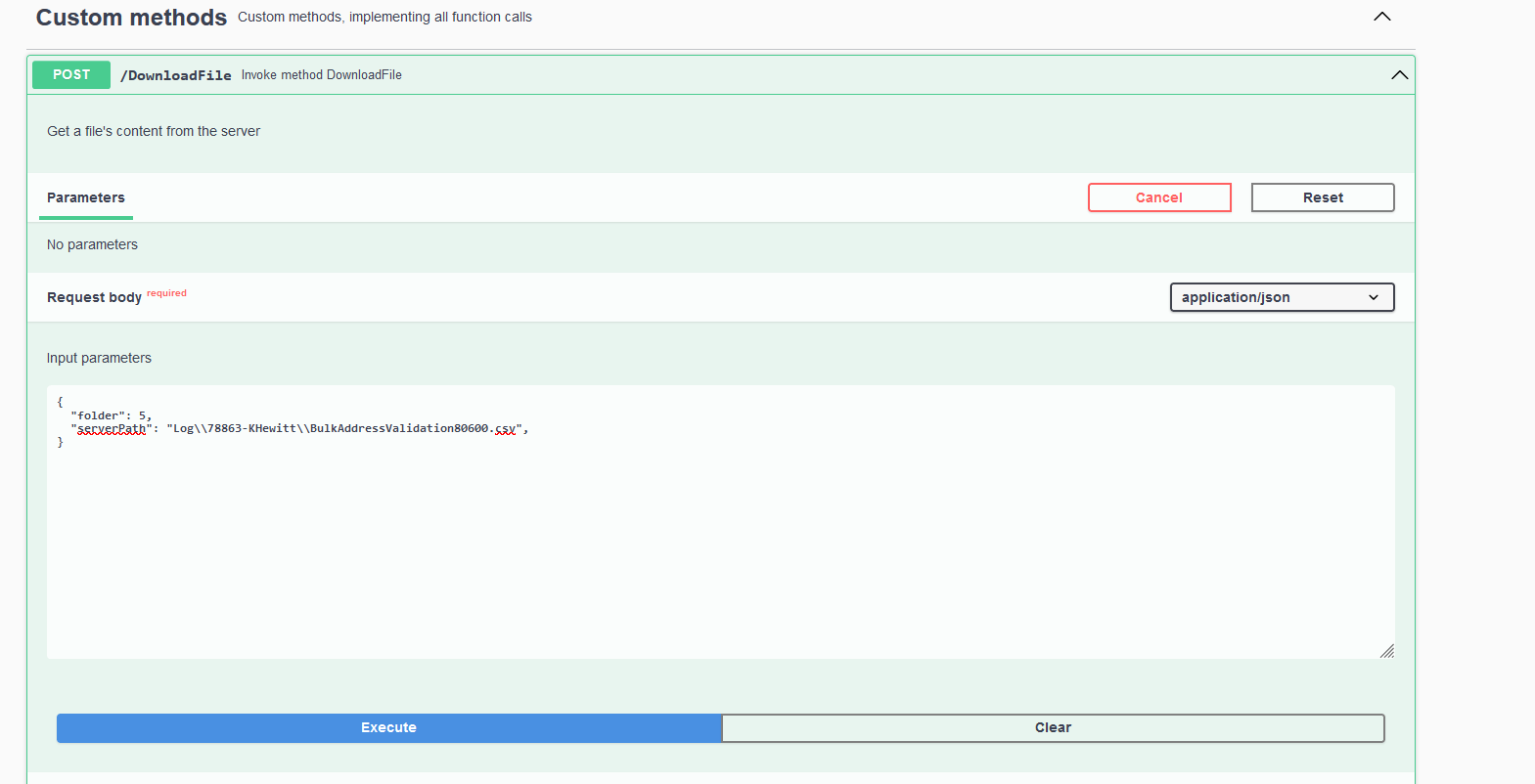

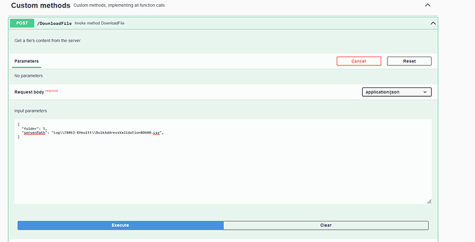

Trying to download it myself thru swagger:
Not quite there… Not sure what part of the path is wrong now
Kinetic in the browser was able to download the file.
