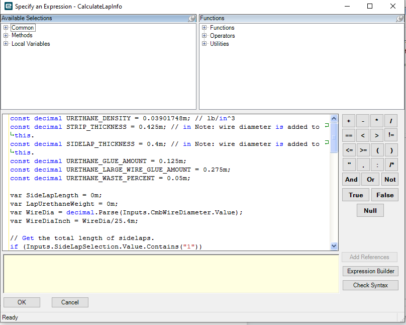

I had several UDMethods that I would use in multiple configurators, and dozens more that had the same structure, just a few different parameters, or with call outs to different Lookup tables. So when I had to make a change, I’d have to go into a dozen configurators and make the same change to the UDMethod code.
I ended up just building a Class Library to store most of the code. Then I’d add the .dll assembly to my methods, and just call the methods there to get the data I needed. It made maintaining and updating much easier.

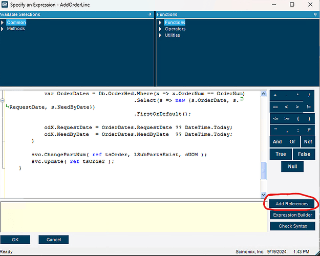

Must be an on prem thing? I can’t even add references, much less custom DLLs

Cloud doesn’t have this button on the Configurator UD Methods Editor?
I’ve done the same. CPQ is pretty cool, but I can’t imagine them pushing an update that would require massive projects for everyone currently using classic PC any time soon.
Oh its there alright… Sometimes I would gaze at it longingly for a minutes on end as I thought about how it could solve all my problems.
That… is very unfortunate :angry: Is it just in the configurator windows? Can you still add custom libraries in your Epicor Functions?
Anything already on the server I think. @klincecum would know better than me
Nope, I can add the libraries epicor provides, no access to the externals folder.
So you have no way to even add the epicor libraries and services?
Well that’s completely useless for cloud, unless there is something we are missing, like a permission or something.
Anyone cloud using classic configurator and has that box enabled?
Pretty much. I’ve managed to do some things with processcaller and other hacks.
Could get all the BO’s if function runner can work via BAQ via process caller – hence why I was asking you about that
I don’t see anything in the help file saying it should be disabled, I wonder if I could import one that had references added
Again, memories - I seem to recall it was available in Server UD Methods but not Client UD Methods, since it might have to be converted to JavaScript for the eCommerce sites.
