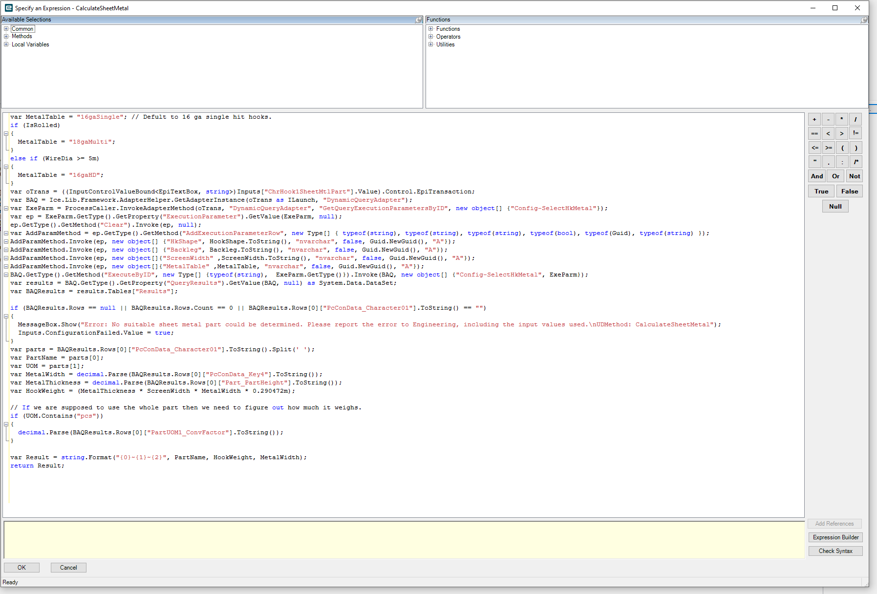

Not sure you can call my chicken scratch code but yes

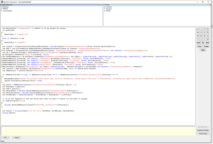

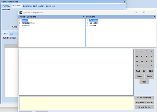

I’m cloud… but using classic CFG, it is clickable in Document Rules (didn’t take screen shot).
Below is Configurator Rules.

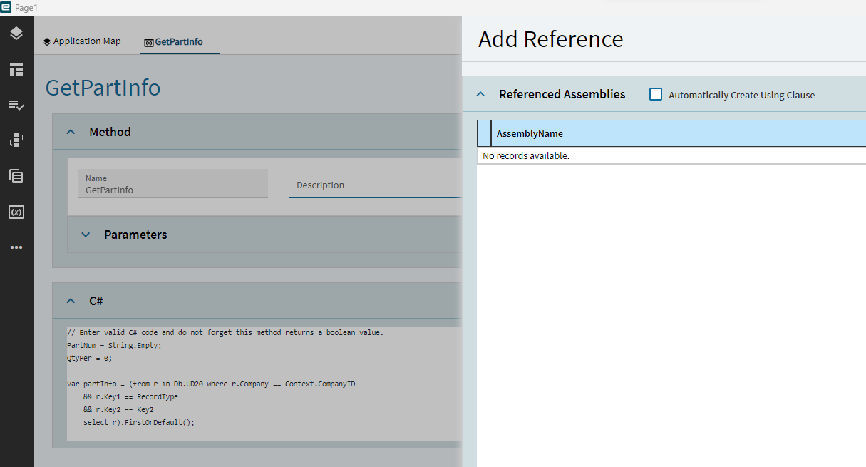

In kinetic designer:

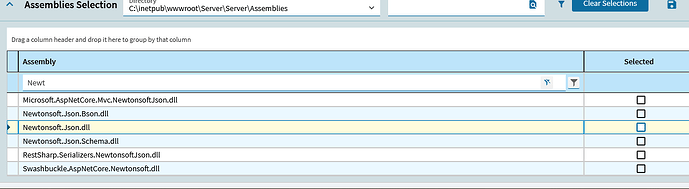

… I haven’t developed any references… but the buttons all work and open up the corresponding forms.

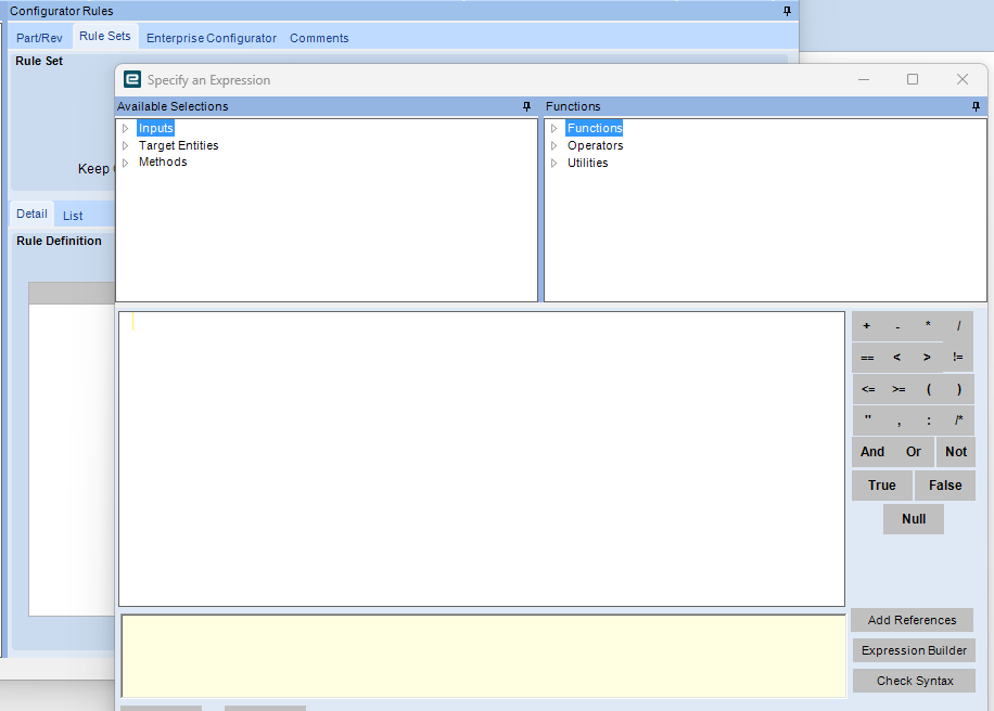

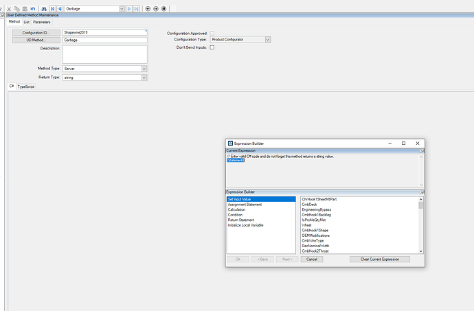

!!! I don’t even get a freeform code window for rules, just the EVIL expression builder

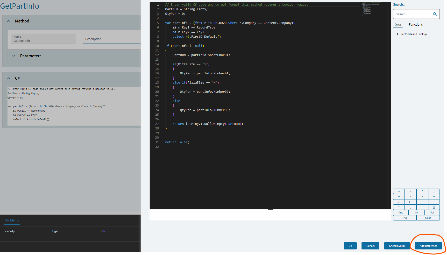

This is the Kinetic User Defined Method screen… bottom right corner opesn up the Add Reference (shown in my previous post).

Did you have a configurator open, and unapproved? I see the code window when the code is read only, but when its in edit mode, its gone.

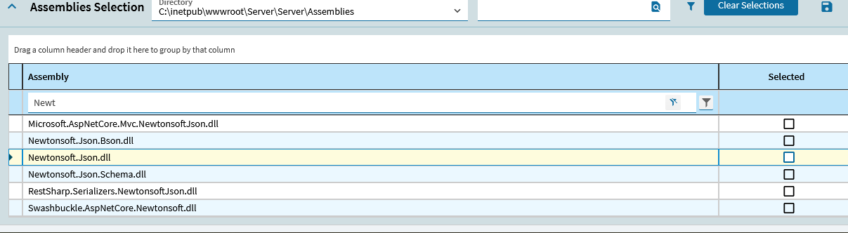

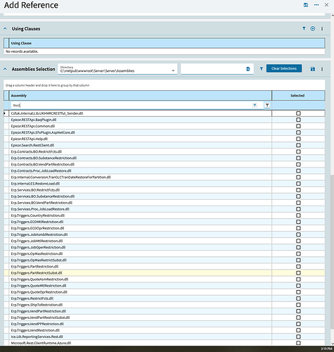

Kinetic looks more promising on the reference front but I haven’t figured out how to add anything yet

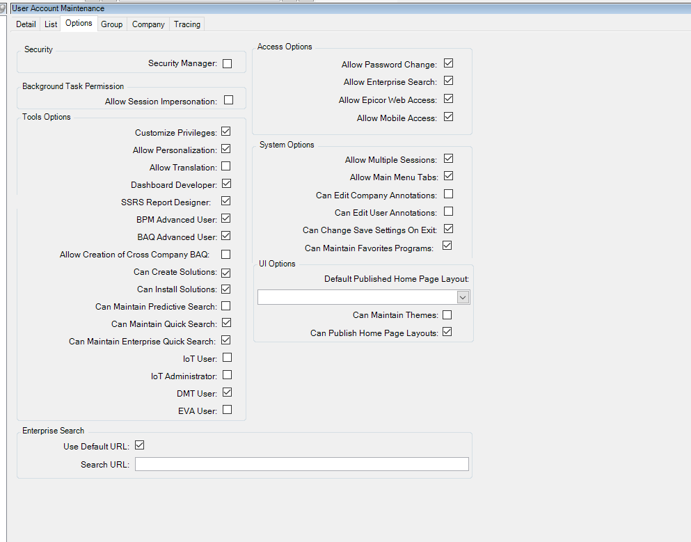

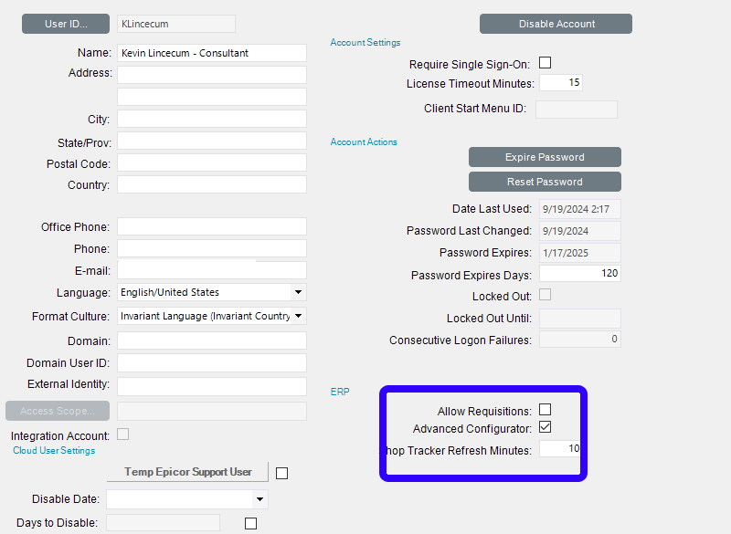

@Evan_Purdy there’s also an Advanced Configurator User checkbox in the user account security maintenance. Make sure that’s checked.
Thats what monkey Kevin was trying to show us
