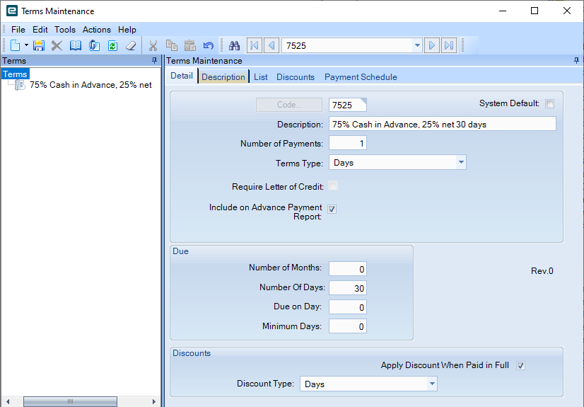

I think that is the term. You don’t make it two terms; your term has two rules. Here’s an example we have with a large deposit and then 25% due after shipment:
Nancy
Different payment on the same sale order.

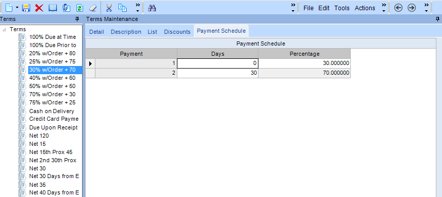

That’s what @Nancy_Hoyt is showing. In the Payment Schedule you set up your two payments. In this case the first one is due immediately for 30%… the second payment (70%) is due 30 days after invoice.
Deposit and 30-Day net we want to capture. I assume what you defined is for the days discount. Am I right?
I’m not sure I follow your question.
The “Days” in the image above is the Days until payment is due, following the processing of the invoice.
So, invoice (1) is created for 30% down on 7/1/2024… payment due date would be 7/1/2024.
Invoice (2) is created for 70% balance on 8/1/2024… payment due date would be 8/31/2024.
