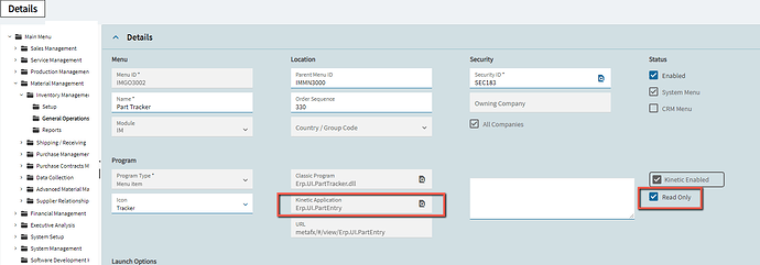

Check Menu Maintenance and drill down to the menu. The Kinetic Application should call Erp.UI.PartEntry and ‘Read Only’ checked. See my example in one of the Part Tracker menu items.
Thank you that worked.
Note that I had to make a copy of the menu item to change the application.
