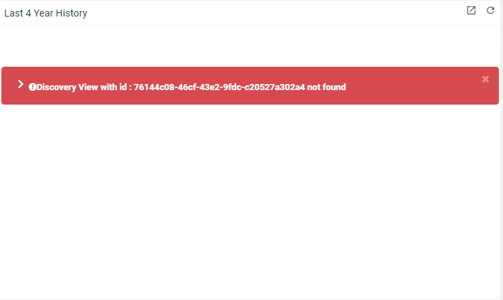

I am testing an upgrade of our system from 10.2.500.26 to 10.2.700.5. Everything seems to work fine except now I get:
Instead of a pretty graph.
Is there a specific way to upgrade the EDD datasource/database?
Thanks!

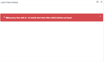

Thanks!
There is not a way to upgrade EDD. You have to export the views from the old version of EDD and re-import. I just had a case open with Epicor on this. Unfortunately their official workaround is rebuild your active homepages.
The good news is they opened a feature enhancement last week from my ticket to add an upgrade process for EDD!

But you still had to rebuild your active homepage, right? Because the GUID changes on import. That’s the issue here. I was able to restore the EDD views and dashboards. But the active homepage stores a static GUID of the view. So until you edit your active homepage and relink to the view you get the error that @Doug.C is getting.

I’ve written a SQL query that allows me to update the XML in the database to use the correct (imported) IDs. I don’t know what I would do with the production database, but it’s easy in the test database…
Exactly, we also got the same issue when upgrading from 10.2.500 to 600, there we lost those views, but luckily there were “easy” to re-do by the functional consultant, then from 600 to 700 we got the same issue and there we created a CASE with Epicor support just to end up with the same solution proposed to you: Export and Re-Import after upgrade.
However, what I did notice was that not Deploying the extension as part of the upgrade steps, allowed us to see those views in the Kinetic Homepage correctly, it was until you deploy the new extension that the DB is overwritten and you lose them all.
