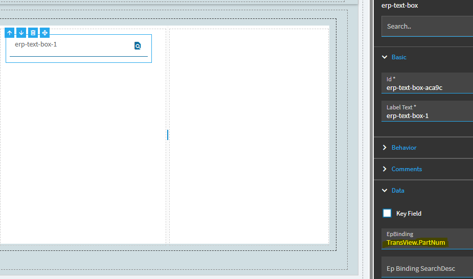

I guess we need to walk through what you’re trying to do. Here’s an extremely simple example:
Textbox bound to TransView.PartNum

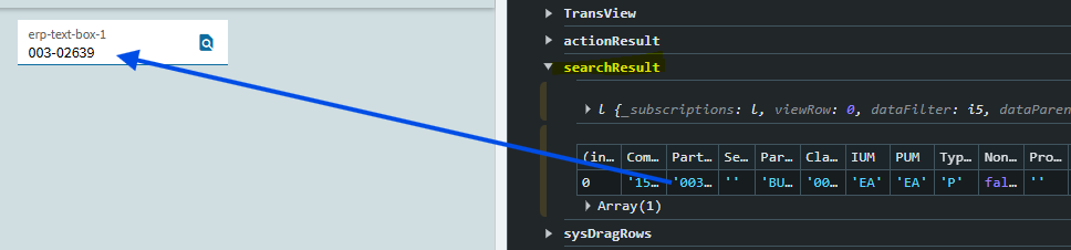

The search-show results are going to be passed to the searchResult dataview.
So, yes, I can use a search-value-set to grab the returned PartNum… and push that value to my original binding of TransView.PartNum
I perform my search and the value is taken from the searchResult dataview and pushed to the TransView.PartNum binding:

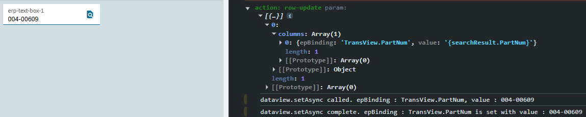

The same can be done via row-update:
The crux of the matter is that the search-show results are, by default, returned to the searchResult dataview. So that is where you can grab the value and send it where you want it.

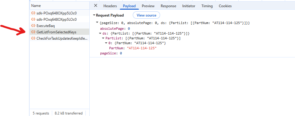

@dcamlin Thanks so much for this help, So my problem now is when I check the payload, it seems to me that the process is not passing the search-show.Seems I am missing something, if you are ok to walk me through this I will appreciate. Because I see yours working seamlessly. I do sincerely appreciate you

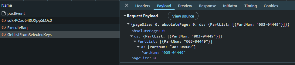

Payload all looks fine, here’s mine:
If you look at your views (in the Console) do you see results in your searchResult dataview?
Yeaaaaaaaa,
