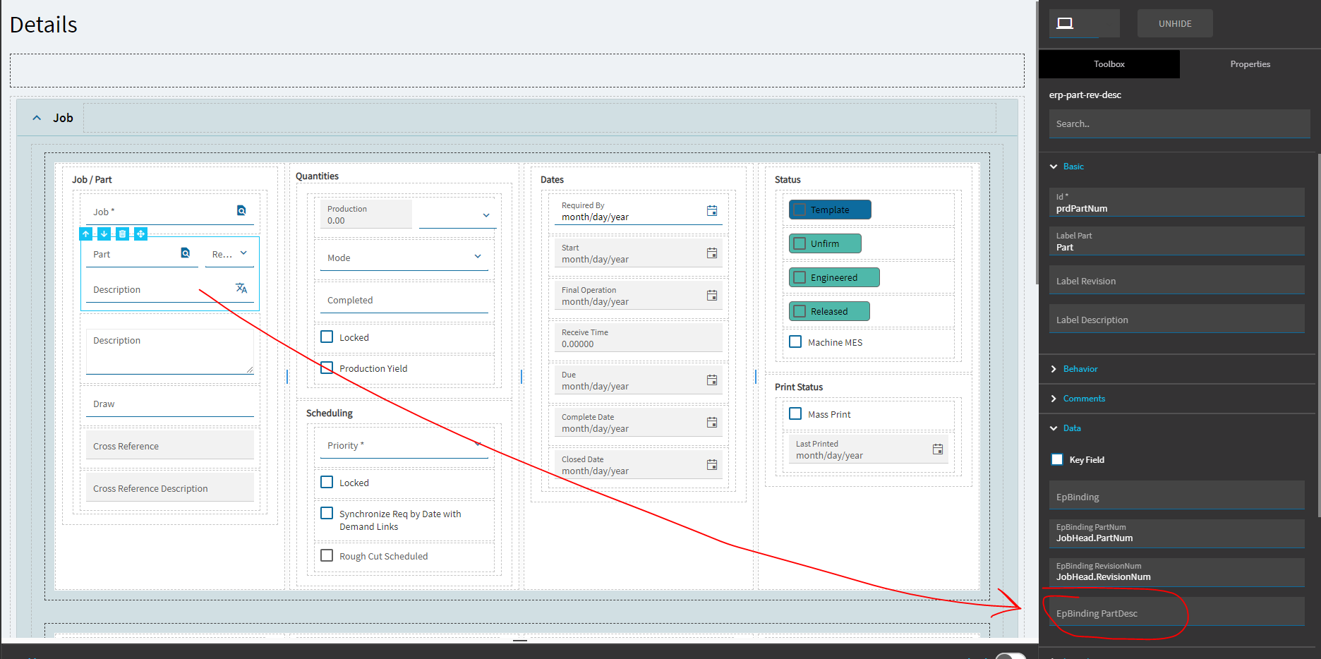

Textbox within a group box (or whatever it is called in Kinetic)
Does anyone know if I can delete a single textbox from this grouping?
This is on Job Entry and is a native control.
I would like the JobHead.PartDescription control to be multiline, but it is a text box and not a “text area…”
Another question, am I able to add a textbox to this native grouping? I tried, but can’t get it to insert there.

Angie, I feel like I am on the right layer. I am in the Details section for the Job.
It is a native component where they have 3 fields in it. If I click the trash can it deletes all three. I only want to delete the description field…
And on top of that I would love to drag in a text area component since description is multiline.
You might have selected the container and not the individual control. You can tell because if you look at the properties after you select the control, the label text should say description (or whatever control you are trying to select). I found I had to click around a lot to grab the right thing.
I feel like I am on it because it has all three bindings in it for all three of those fields (part, rev, and description). I guess I just can’t get rid of one of those fields in the component.
That’s strange, it is like its multiple controls all bundled together on that screen.
Yeah, is there a name for that?
I think its a special control because its actually available to select in the toolbox.
Okay, well here is what I got from support. You have to delete the epi binding and then the control disappears when you preview or launch the app after applying the customization.
