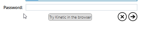

So now that the prompt to log in using the browser front and center in 2024.1, I am finally forced to confront the edge agent debacle after avoiding it thus far.
What I don’t think Epicor understands is that when cloud customers try to use the browser, you are taking a scenario where each individual end user can self serve their install through the saas download site without any admin permissions, and forcing a process where the end user has to download and install the client. Then open a support ticket. Then wait for IT to come around and deploy the edge agent on their computer for them. All so they can use the browser. Either that or IT has to take over installing everyone’s client for them and do the edge agent at the same time. Either way this is a higher burden on a cloud customers than just sticking with the classic client to begin with.
Why is this so difficult? Suggestions to make it easier? Any chance the edge agent would ever be part of the client install or at least not require admin permissions? It seems like the whole dream of no client installs being required once we go to the browser has just completely died. Not only will a client install be required forever, but on top of that its a more difficult and complicated client install than the one we already have!
