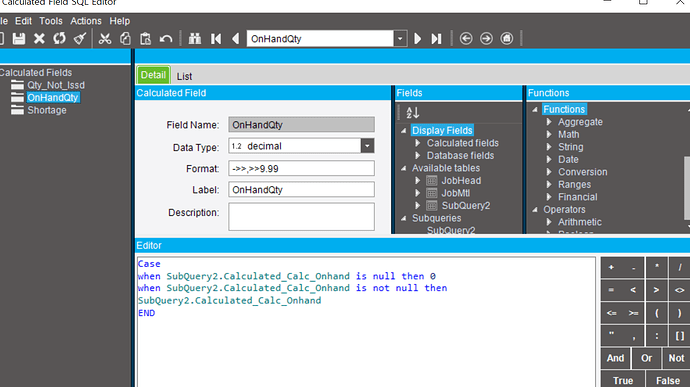

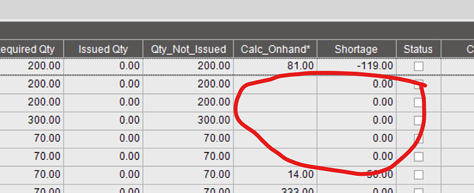

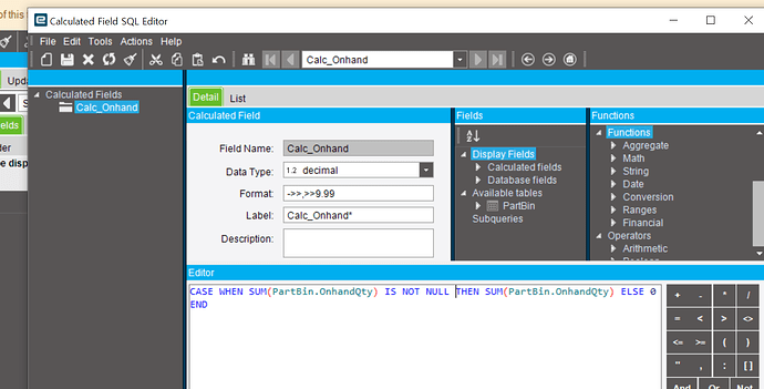

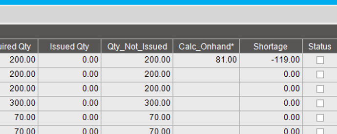

I am trying to create a report in BAQ showing shortages. But, the shortage did not appear in some lines, and when I checked, it was because 0 was not displayed in the on-hand column when the on-hand quantity was 0. It was displayed as just an empty column.
I have attached my Calculated Field that calculates the on hand. Could you please take a look and see what the problem is?
Thank you in advance!

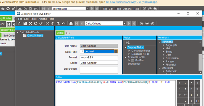

Try this, CASE WHEN SUM(PartBin.OnhandQty) IS NOT NULL THEN SUM(PartBin.OnhandQty ELSE 0 END
Unfortunately, even though I changed it with your tips, this issue still persists.

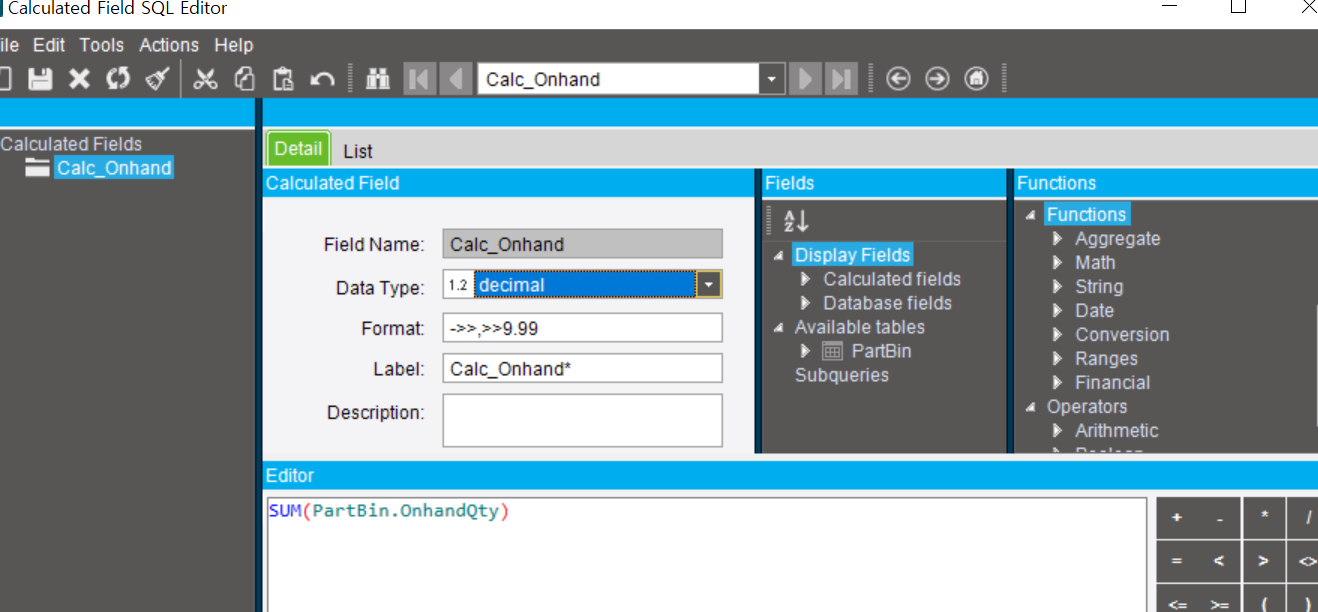

change it to just parbin.onhandqty and show us the results
I tried changing this but the result was the same.

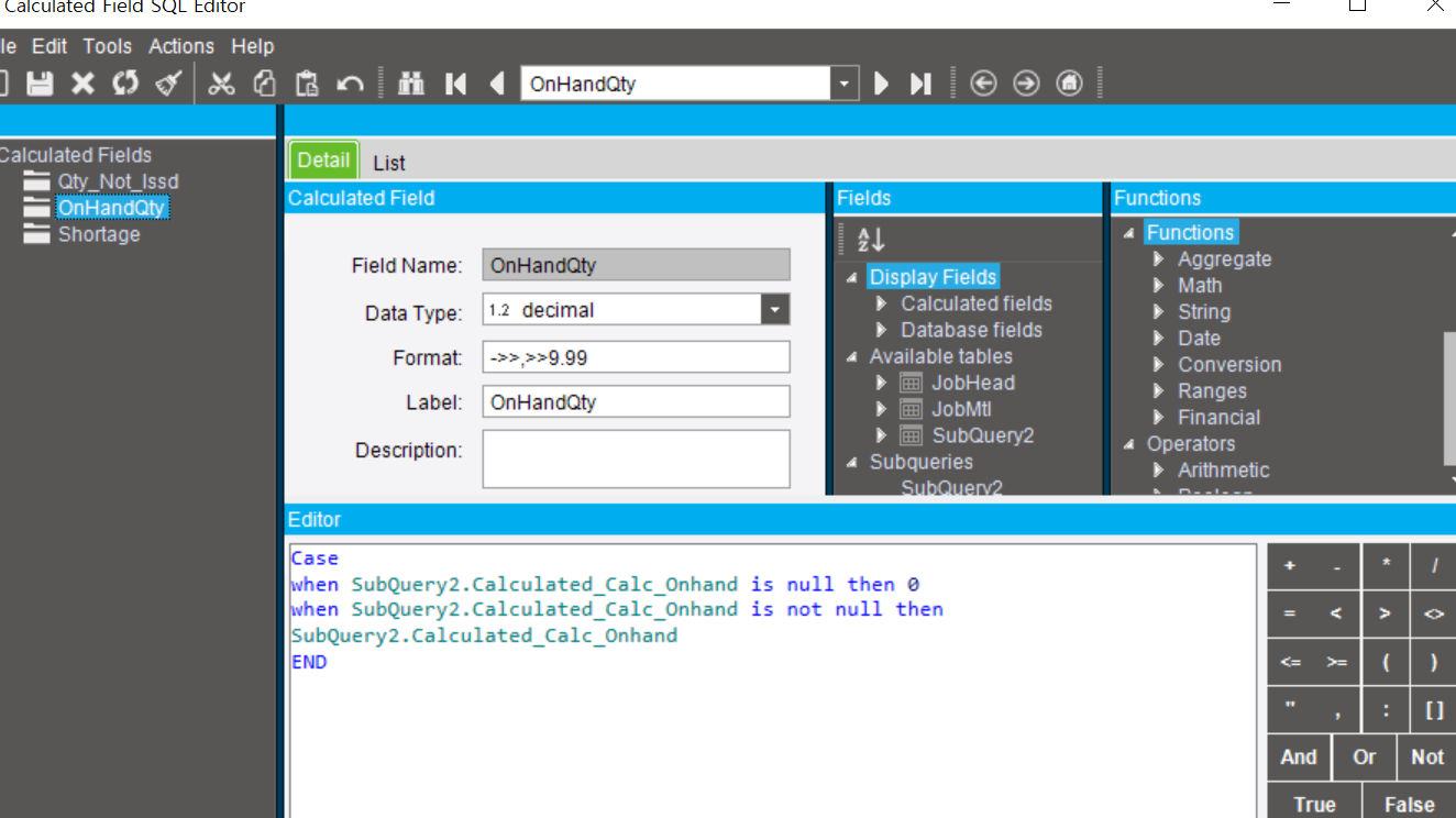

I just created a new calculation SQL to convert null to the number 0.
Thank you to everyone who helped.
I think u must create the Calculation Field to convert the null using Case when.
Yes. I already solved this issue that way.
yes, I wanted it without the sum, but the whole point was to see if it was null :wink:
Glad ya got it!

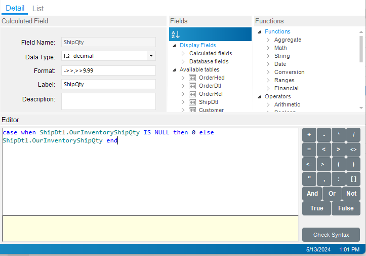

Another way to do it would have been to use the ISNULL function.
ISNULL( Sum(ShipDtl.OurInventoryShipQty), 0 )
