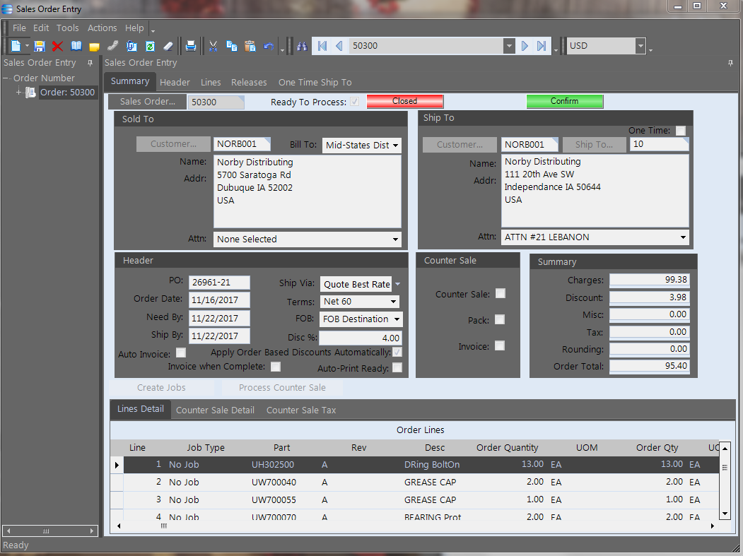

I got extremely sick of the default theme and color scheme. I like darker skins/themes in most applications.
Anyways, this is my first time, and in Office 2016 I love the dark theme, so I am going off that theme.
This is far from finished, but how do I get rid of the blue background?
The picture below is what is troubling me, usually within hovering over areas it tells me to click 1-5 etc. When I hit C I find no information to where I change the color.
The below is a picture of what it pops up instead
I actually figured this out.
Took a while to realize what these were for (I knew the blue green red and yellow were the buttons for ie: credit hold, closed, etc) but I overlooked the Default_Epiform.
it’s slowly getting there.

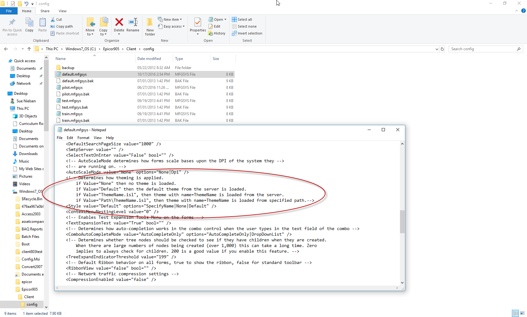

Each client machine has a default.mfgsys text file in the Epicor\Client\config directory (may not be Epicor, it will be wherever you installed Epicor client). You can set the theme in Epicor as default (under Actions in theme maintenance). You can set each client machine to use the default theme, no theme, or “hardcode” a theme.
You can set different styles for test and pilot the same way.

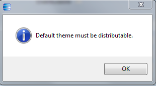

I’m tried going to theme maintence>actions>make default but it pops up the below and I don’t want to default everyones.
If you have the office2016 set as default everyone may get it. Try making the standard theme (not sure what that is) default and keep your config file “hardcoded”. Or…try changing the config file for a user that doesn’t want your theme to None for the style option. Either way should work.

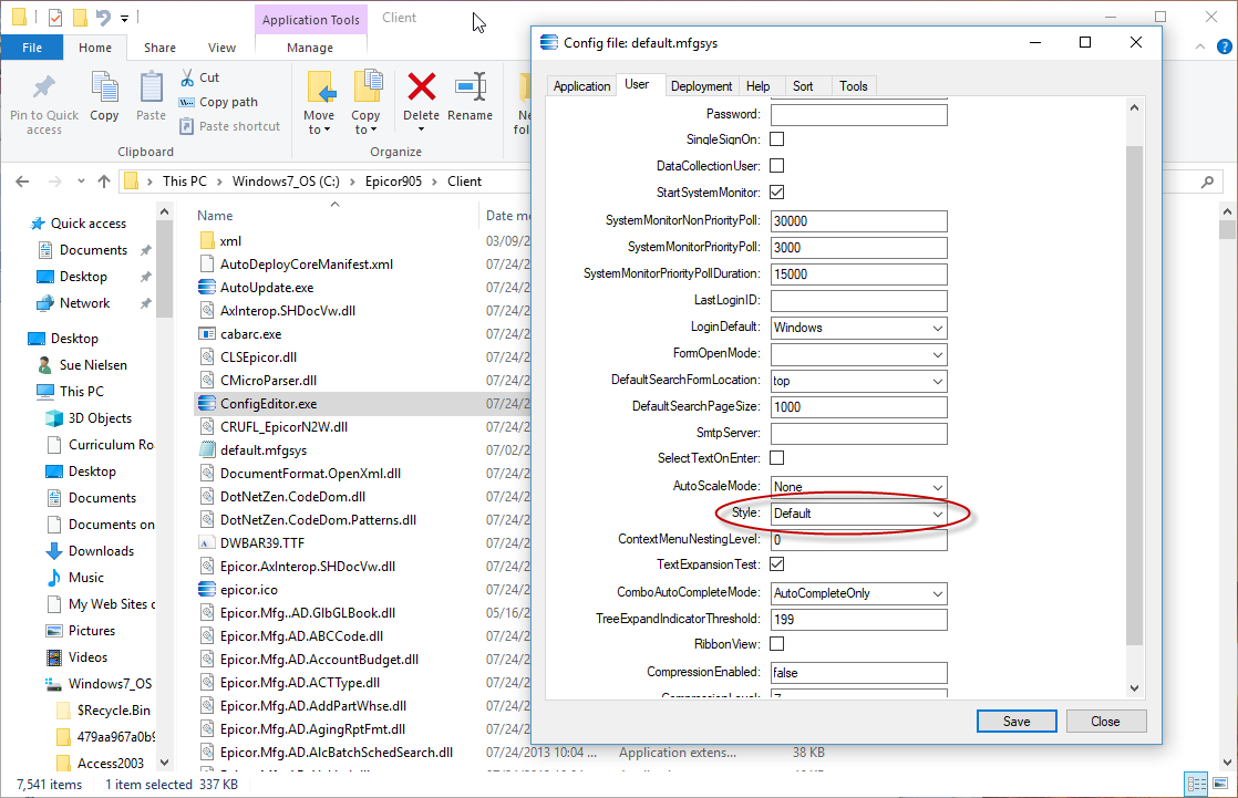

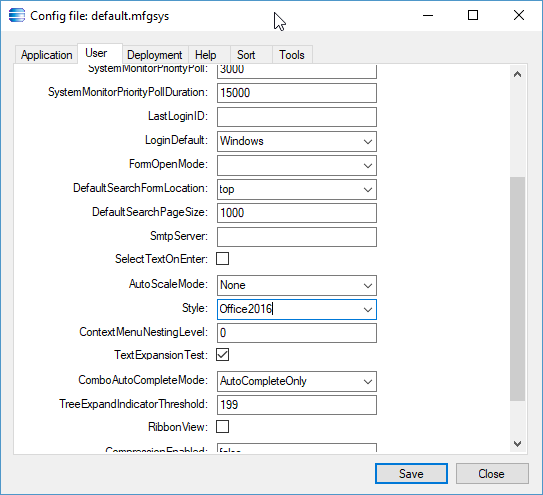

Just my 2 cents … But you should use the ConfigEditor program to make changes to the .configsys files.
It should be in the director that holds the “config” folder where the configsys files are. Mine is located:
C:\Epicor\ERP10.1Client\Client\ConfigEditor.exe
Edit: originally called the configsys files MfgSys.
Edit #2: the Config Editor window will often pop up behind other windows. Check the task bar or ALT+tab through the open programs.

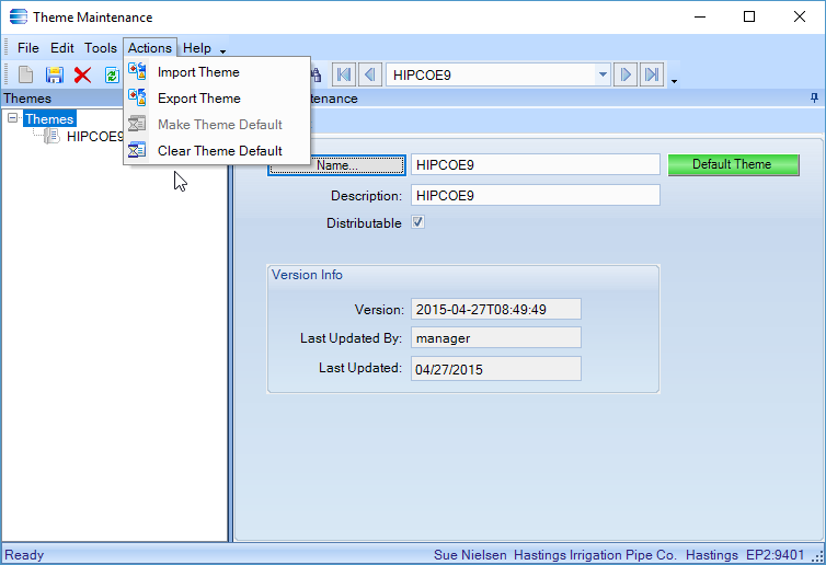

This is where you set your default style (theme) in theme maintenance.
If you have a default theme set and the client config style is set at , this is the theme you will get. I think the theme Office2007 is the E9 default theme. You could set Office 2007 as the default theme in Epicor for all users. Your special config setting on your machine should cause Epicor to use your custom theme (Office 2016) on your machine. Did this help?
Good point Calvin, I tend to forget it’s there. You can find it under the Epicor\Client directory. It is much more user friendly!

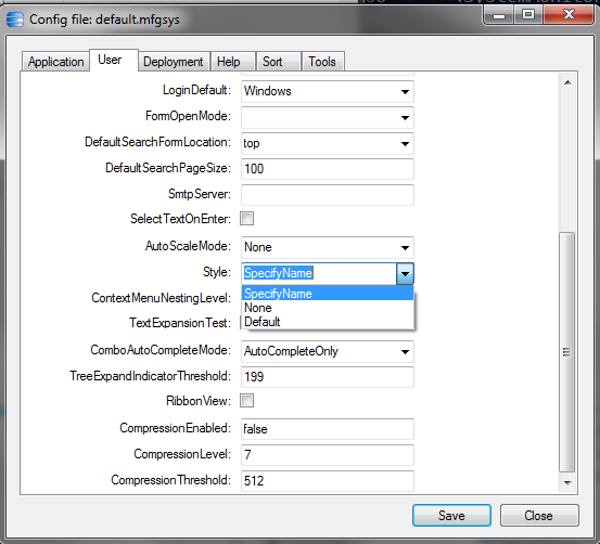

To change just mine do I enter my credentials (log in) and then go to style and change it to one of these? but what do I do after ? I clicked Specify Name thinking I would then give the path name. I am so confused. and logged in and it changed the layout (like if i was to “unload style theme” ) but it was not the Office2016 I wanted (default is the 2007 I believe).
When you set a theme as default using Theme Maintenance in Epicor you are controlling a setting for all Epicor users. When you use the ConfigEditor on your client machine you can override the Epicor setting controlled in Theme maintenance. Try entering “Office2016” in the Style on your machine.
It doesn’t do anything, I have the style in the same folder as the others though, and even under theme maintance it’s listed in the search. I’ve even tried Office2016.isl too, it keeps running another theme that is not the actual default (if i was unloading style them)
Ahhh…I’ve never tried to test a setting using the Styling options. Try this…once the theme is created and set as distributable (check the check box in theme maintenance) you should close theme maintenance. Close Epicor. Set your config file and then open Epicor.
I got it I had to put the entire path in the text box, but when I log in under manager it shows the same theme still, but I hope it’s because it’s under my computer, I’m having another co worker test to see if shows on her computer when she logs in, before I say this works
It worked!
She logged into epicor on her computer and it was the default 2007. :smile:
