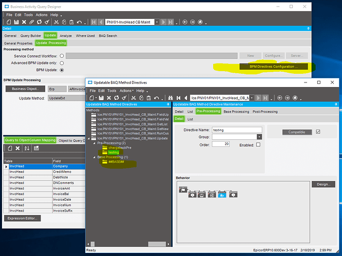

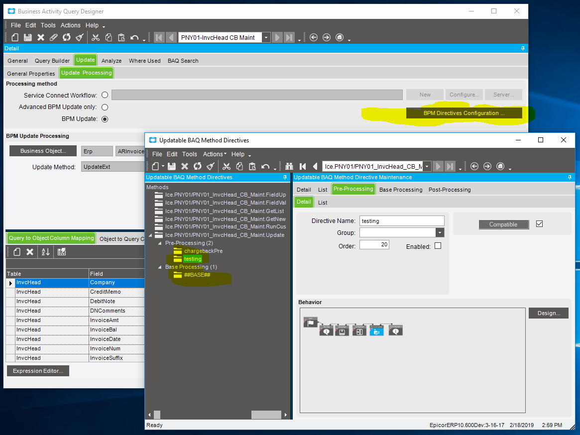

Vicki,
Sadly I don’t remember specifically what we did in order to get it to work, but hopefully this will help. You have to click the BPM Directives button and then create directives for the .Update method as seen in this screenshot. We have a pre-Processing and Base-Processing directive. The Base directive is merely defined and is empty, I don’t remember if that has to be there or not for it to work but it doesn’t hurt to have it there. The functionality we needed was in the pre-processing.
Hope this helps, good luck.
bb
If you arent implementing any Epicor generated procedures, you can select Advanced BPM update only - this will allow you to use only your custom methods.
