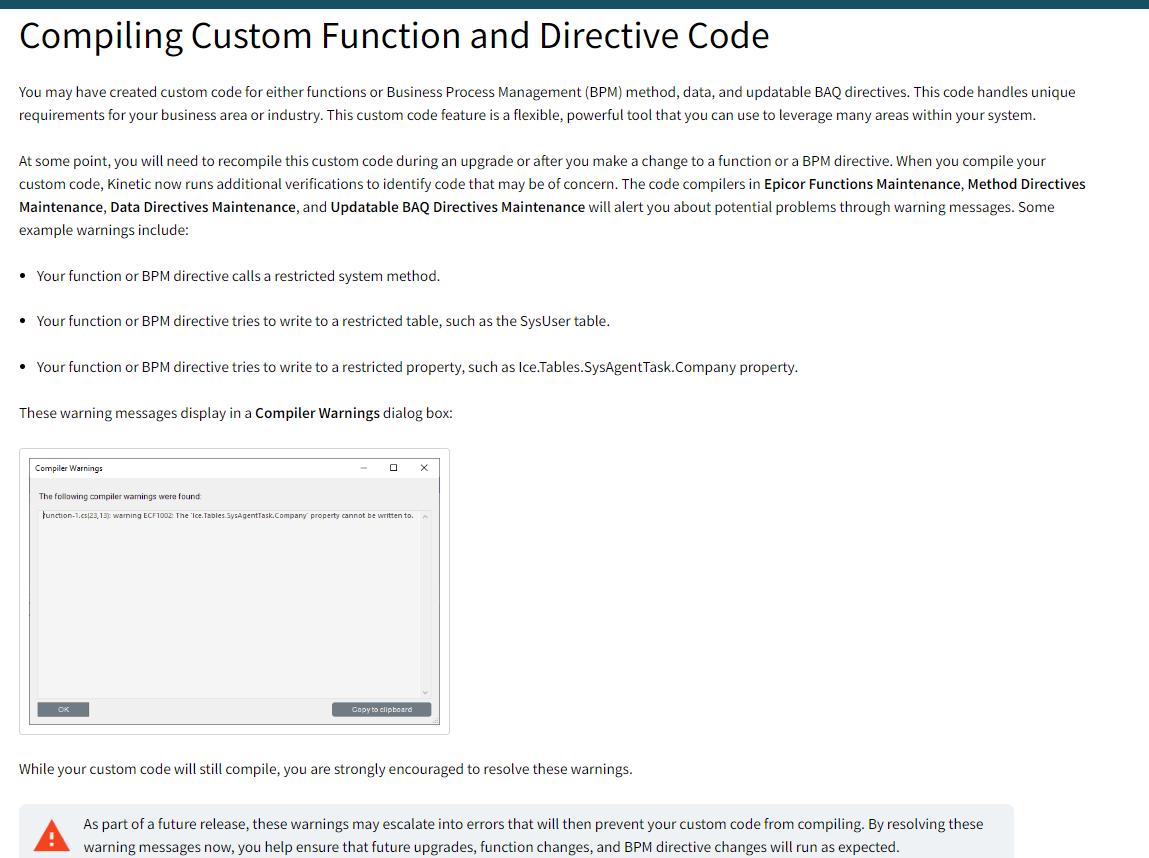

So system.io I (sort of) understand. But I don’t get this warning. What is it that Epicor objects to here?
warning ECF1002: The ‘System.Reflection.MemberInfo.Name’ property cannot be read.

This is all I can find in the documentation. Is there more somewhere?
