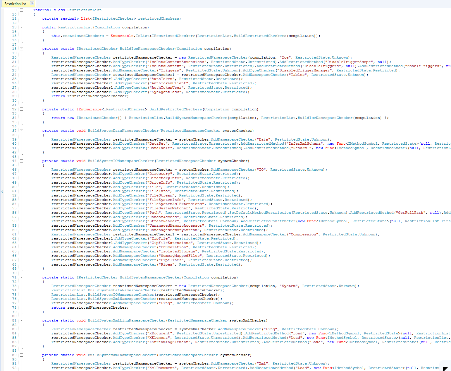

I think that may be a bug.
Epicor might have forgotten to insert
INSERT INTO Ice.SysConfig (Key1, Key2, SysCharacter01)
VALUES (N'CustomCodeAnalysis', N'Enabled', 'false');
Its neither true or false (the row doesnt exist) which will cause their flag = !bool.TryParse((string)obj, ref enabled) || enabled; to return true, maybe something that needs to be added to the upgrade process @Rich @Epic_Santiago - worked for me on-prem.
To give you an idea what Custom Code Analyzer tries to restrict
