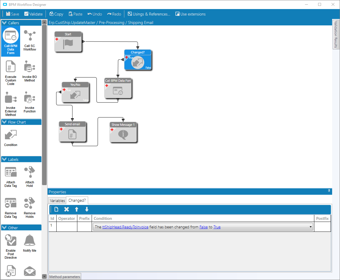

I have a BPM with some custom code on Erp.CustShip.UpdateMaster:
The idea is that when the “Shipped” box in Customer Shipment Entry is checked, then it will prompt the user to send a shipping notification email to the customer. However, when this error occurs we don’t even get to the prompt (BPM data form). The only clues we’ve found are these:
