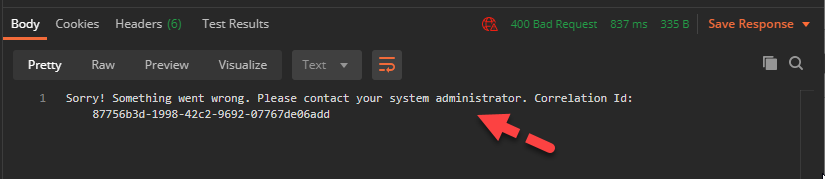

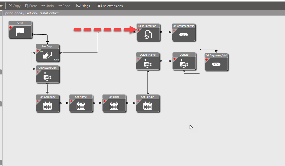

Using the “Raise Exception” Widget in my function did indeed raise an exception, but I could not get it to send an output message other than the default “something went wrong” message, regardless of what I set my exception message to be.
I did try setting my output variable prior to the exception in his screenshot as well…
A postman call to that function to trigger the exception then shows this generic message (with a 400 error, thankfully)

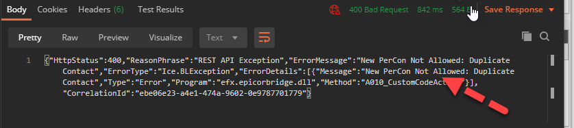

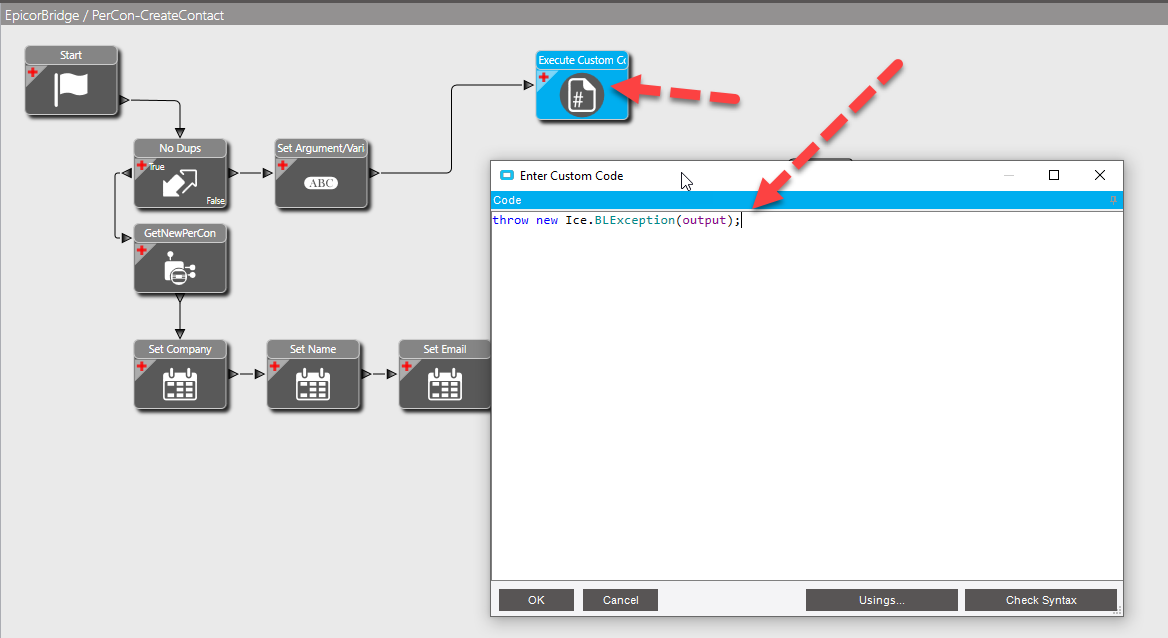

In order to give it some context however, I found a custom code widget was a good way to both throw a 400 exception and display a custom message back to the calling app

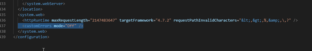

in your web config for the app server turn off customerrors.
Then if you do throw new Ice.BLException(“my message”); it will show up in the log and response

Does this just require an IIS recycle to get it going? Good to know though I think I’ll go this route
it will restart app server for you because you edit web.config
But this approach is not recommended because all exceptions will be shown by IIS with this flag.
ooo, so in this particular use case, I might be better off using the custom code approach?
yes, this is better from security POV
