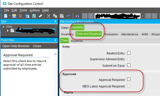

see if this gets you what you want.

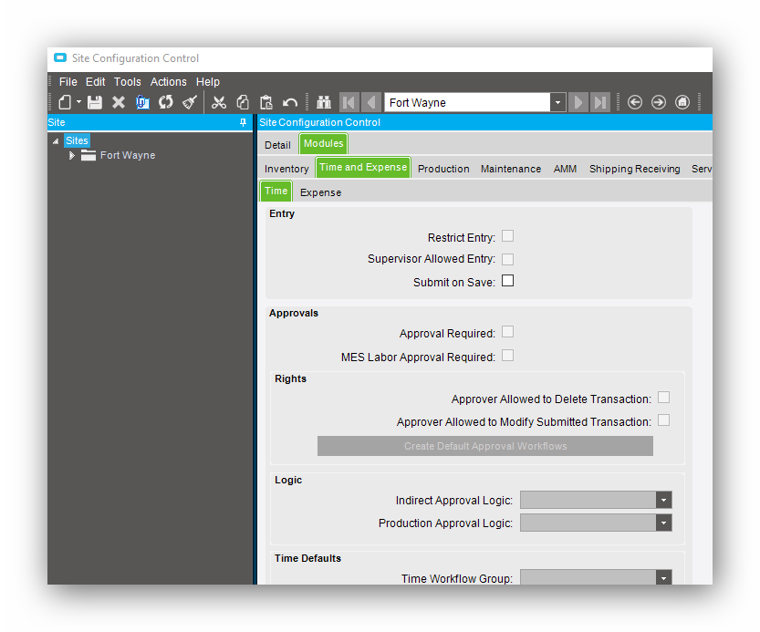

Craig beat me to it. But for what it’s worth, those options aren’t available in our installation. I believe it requires the Expense Approvals module (not sure of the exact module name).

Back to the question at hand, though. @StuartP – if you have the Time Management Module, you can use the options Craig pointed out so that labor entries require approval before being submitted. If you don’t have the module, you may be able to set up a Method Directive BPM on Labor.Update to check if a labor entry is being closed from MES and to un-approve it after it’s submitted. You’d need to be careful with this, though. A lot of other tables are touched when labor is entered and approved, so you need to make sure to follow the correct process calls in order for it all to match up correctly.
Thanks everyone for the help. We do not have the Time and Expense module. Does anyone know without that how the system approves the time we record as we do jobs?
It’s auto approved when they clock out of a LaborDtl. You would have to do some tracing and figure out what is firing when that happens and try to skirt them back out of approved in a post processing BPM or something.
