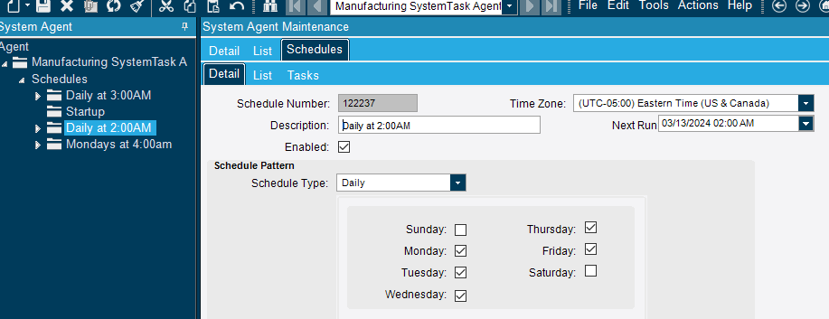

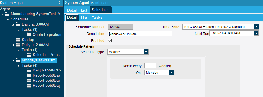

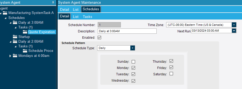

I don’t know why the schedule number is so large for two of the schedules. I can’t guarantee that I didn’t reuse the Daily at 3:00AM schedule that came over from the conversion, and create new one for the other two.
It looks like none of your schedules are set to run on Sunday, which is probably why it worked for you. They need to fix this so it works for tasks that do run ON the day of the time change.
You might be right about running on Sunday being the problem (or the solution!). I just checked our old 10.2.700 schedules, and they were set to run 7 days a week, and I always had to manually adjust the time after DST change.
