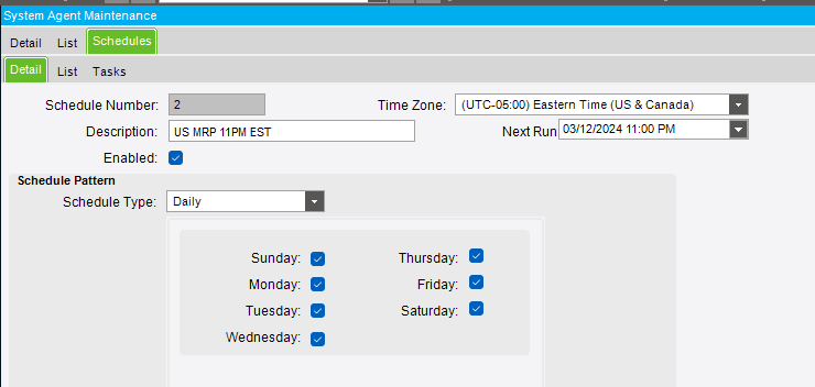

During Go-Live weekend, I scheduled 6 new tasks using new System Agent Schedules with Time Zone. For the next three weeks the tasks ran at the correct clock time. Then, this week, I was pleasantly surprised to find that the tasks continued to run at the correct clock time (which is now Daylight Savings Time), without me having to manually adjust the schedule!.
So, there is some combination of conditions that allows the System Agent to figure out time changes.

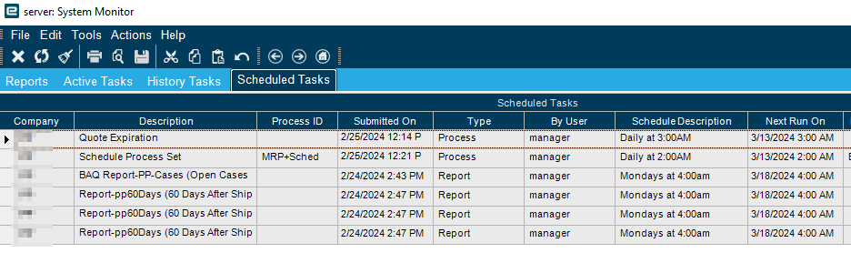

Would love to know what that is. Would you share a screenshot of one of the schedules that adjusted correctly?
Here is one of mine that did not (it jumped to 12am, which, if I hadn’t fixed it, would have meant no MRP run for Monday at all):
