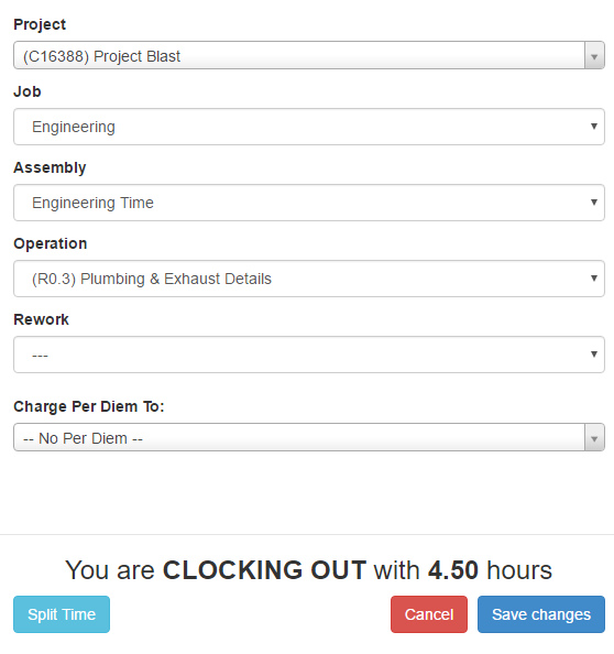

We are on 905.702A. When a user goes to clock out they get this screen, which basically filters down on Project information and Job/assm/operation information. It definitely took some time to setup, but has been working really well for us. It is very heavily customized on the PHP side. I know PHP isn’t the best for math, but we do a bunch of math to correct issues that occur when you push into time entry. For example, when you have salaried employees, their hours get put into time entry, if they work more than 40 hours, it continues to use the same labor rate, which will artificially inflate the labor costs against your project. So we have calculations to adjust the labor rate based on how many hours the employee worked that week, as a result we only push time into epicor once a week, so our epicor data lags behind a week. We have real time reported for hours only in our web applications:
Hopefully this gives you some ideas. Be glad to help any other way I can.
-Bobby
