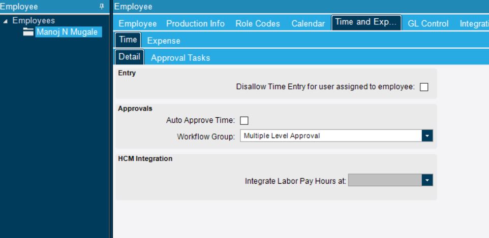

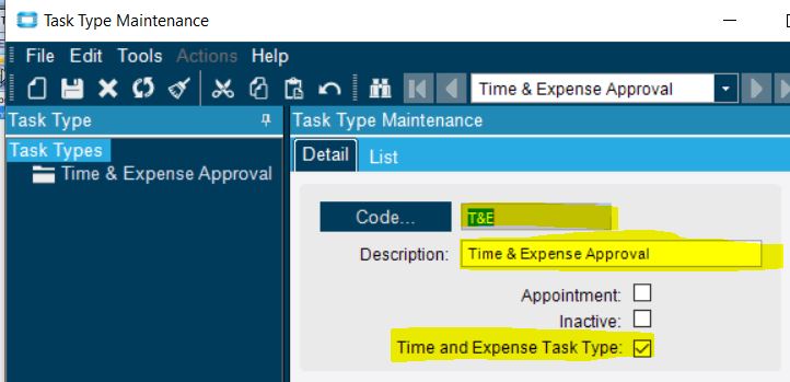

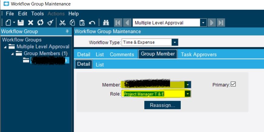

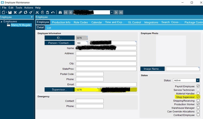

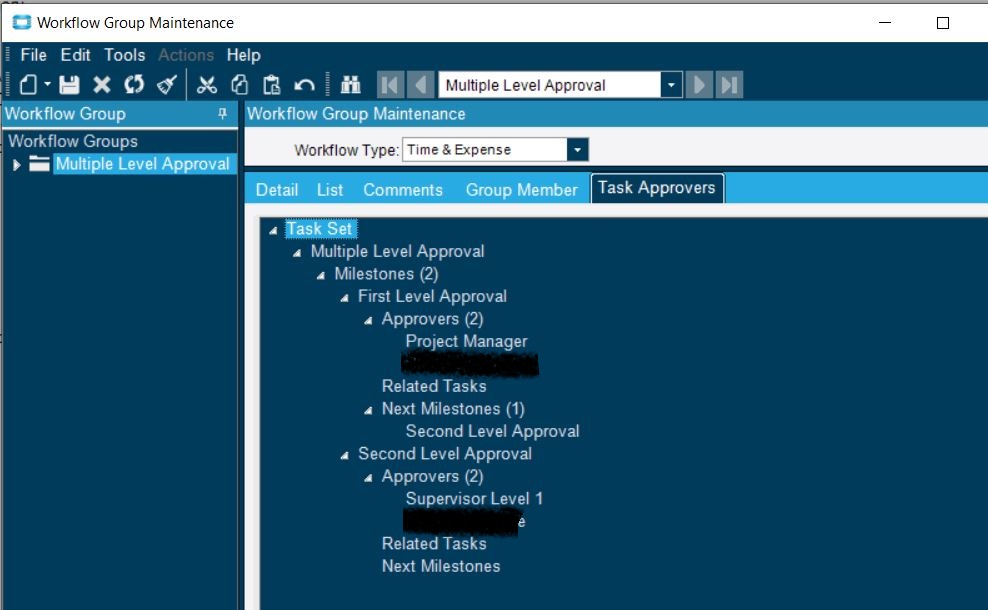

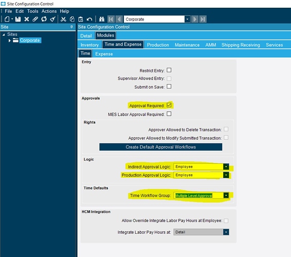

We have implemented the Multiple Level Approval for Time & Expense Management. We have set the full environment refer to attached file. But approval is not working fine. No entries are visible to second level approver after approving by first approver. Time and expense entries are appearing Partially Approved.
2
Dear experts, We have remove all the setup and did all setup from starting. After that approval sequence is working fine. But when both approvers have approved the Time Detail Entry, still entry status is appearing Partially Approved.
Could any one help us to fill this gap?

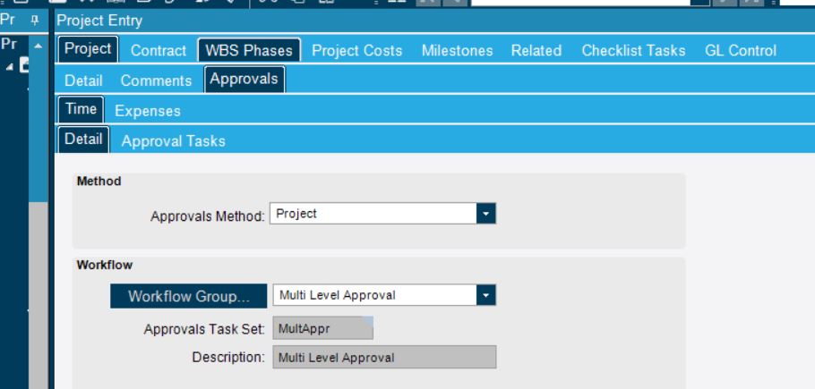

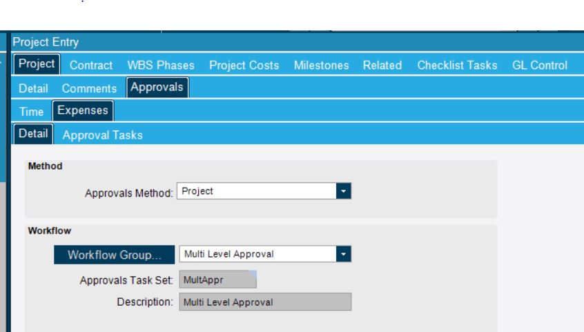

Dear @Kimberley, I have resolved this issue after long time. It’s not a bug. Epicor functionality is working fine. If you entering Time and Expense for Projects, You must have to select the workflow group in Project Entry under Time and Expense sheet. After that it will work fine.
