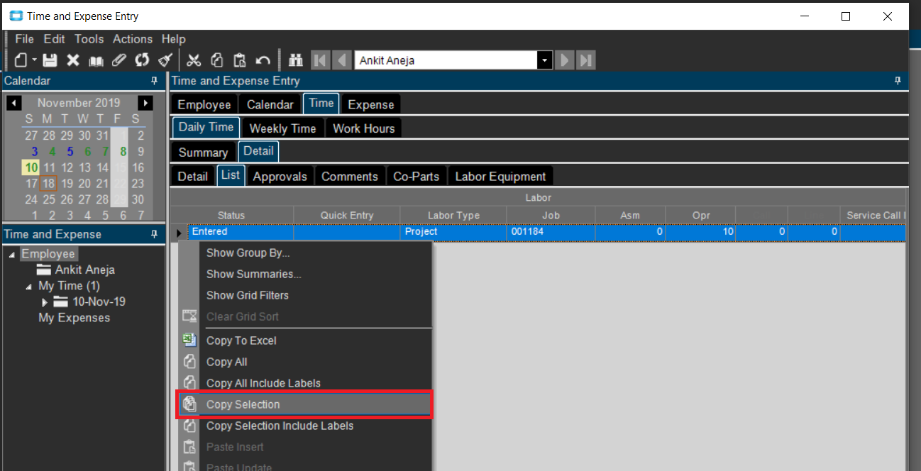

Dear Experts, Time & Expense Entry while Copy Selection and Paste Insert the Time Detail under list system is throwing error “Invalid Job Operation Sequence.”

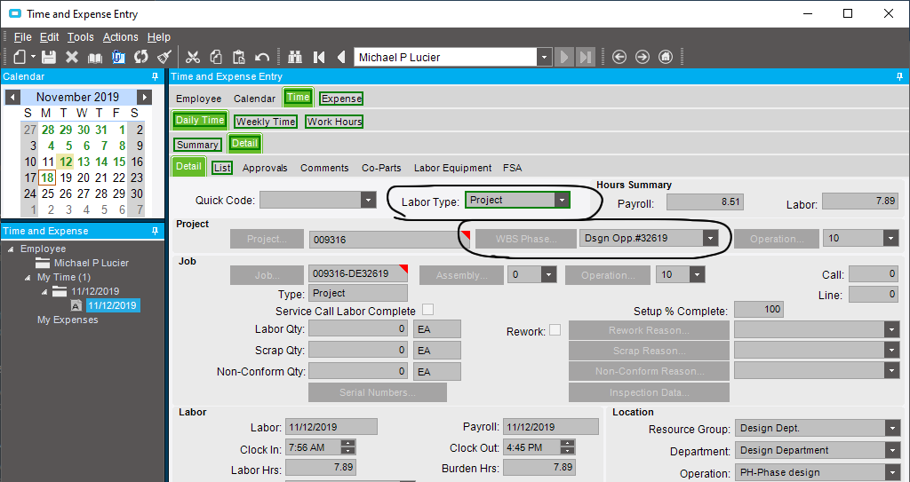

When I’m Paste Insert-ing records into manufacturing jobs, I get no errors.
But when I do the same for Project jobs, I get the same error. I was just seeing this today.
What I noticed is that my Excel columns don’t have the WBS Phase:
Choosing the Project/Phase, it automagically fills in the Job (WBS Job) for you so you don’t have the ability to choose the other fields. Project jobs (Type = J) don’t use the other Production Job fields.
Your excel data doesn’t have a column titled “Project Phase”
I would also try re-arranging the columns in the list view, putting the project related fields (ProjectID, Project Phase, and Opr) first, and only trying to paste those
