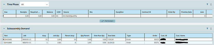

This is the end result… Kinetic Time Phase form with an added grid showing “Subassembly Demand”.
In this example, the part itself had (0) on-hand quantity and (0) demand, according to the base Time Phase. But, with the new added grid, you can see Qty (4) of this part was actually going through production as subassemblies on (2) different jobs for (2) different customer orders.

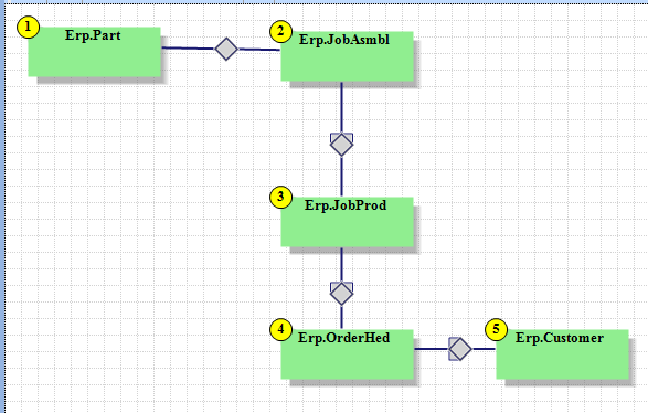

Created a pretty simple BAQ:
I included OrderHed & Customer so, if a sub-assembly was being produced for a customer order, I could see the customer’s CustID & Name in the results. JobProd has the OrderNum, but I had to bounce through OrderHed to get link the Customer table to get that info.

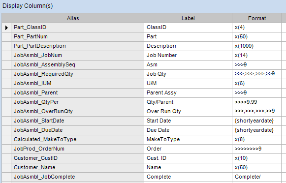

Below are the Display Columns:

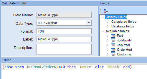

I created the Calculated_MakeToType field so I could see if the sub-assembly was being made as part of a stock job, or a customer order. Basically, if the OrderNum > 0, then it was for an order… otherwise it was a stock job.

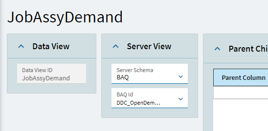

Added a new BAQ DataView to pull in my BAQ results.

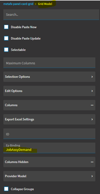

Properties > Grid Model
Set Ep Binding to the name of the new DataView

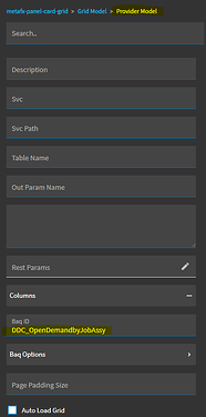

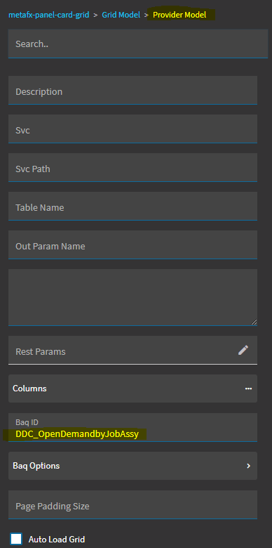

Properties > Grid Model > Provider Model
Linked it to the BAQ

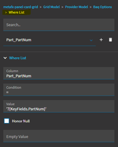

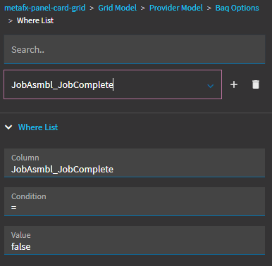

Properties > Grid Model > Provider Model > BAQ Options > Where List
These settings filter the grid results:
Part_PartNum = ‘?{KeyFields.PartNum}’
JobAsmbl_JobComplete = false

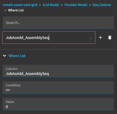

JobAsmbl_AssemblySeq <> 0
… because “0” level assemblies are already picked up by the Out-of-the-Box Time Phase.

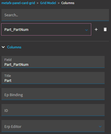

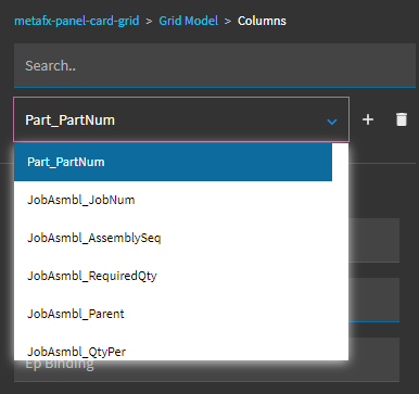

Then I went back to add the columns I wanted to see in the final grid:
Properties > Grid Model > Columns
Just need to add “Field” and “Title” for each:
Repeat for each column you want to include in the grid.
