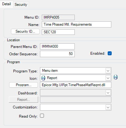

I’m not seeing where the RDD is located. This is what I see under Menu Maintenance -
I don’t see anything listed under Report Definitions for the report.

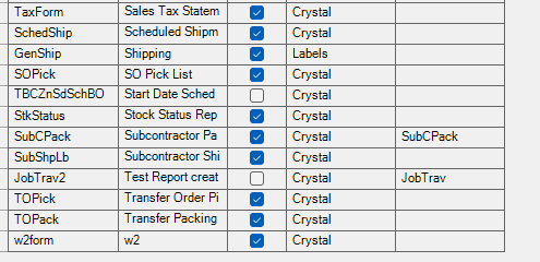

The RDD is under System Management/Company Maintenance
This, correct?
I don’t see an RDD for Time Phase in there.
Sorry, I am not very proficient in Vantage. I always forget that they created custom dlls for some reports. This is one of those reports. Sorry I can’t be more help.
No worries. They did a lot of weird things in Vantage. I wish I could get us off of this version but it’s not in the budget yet. And, the opinion is if it works, it works.
Most of what you see in Time Phase exists in the PartDtl table. You can build a BAQ Report off of that if you like.
