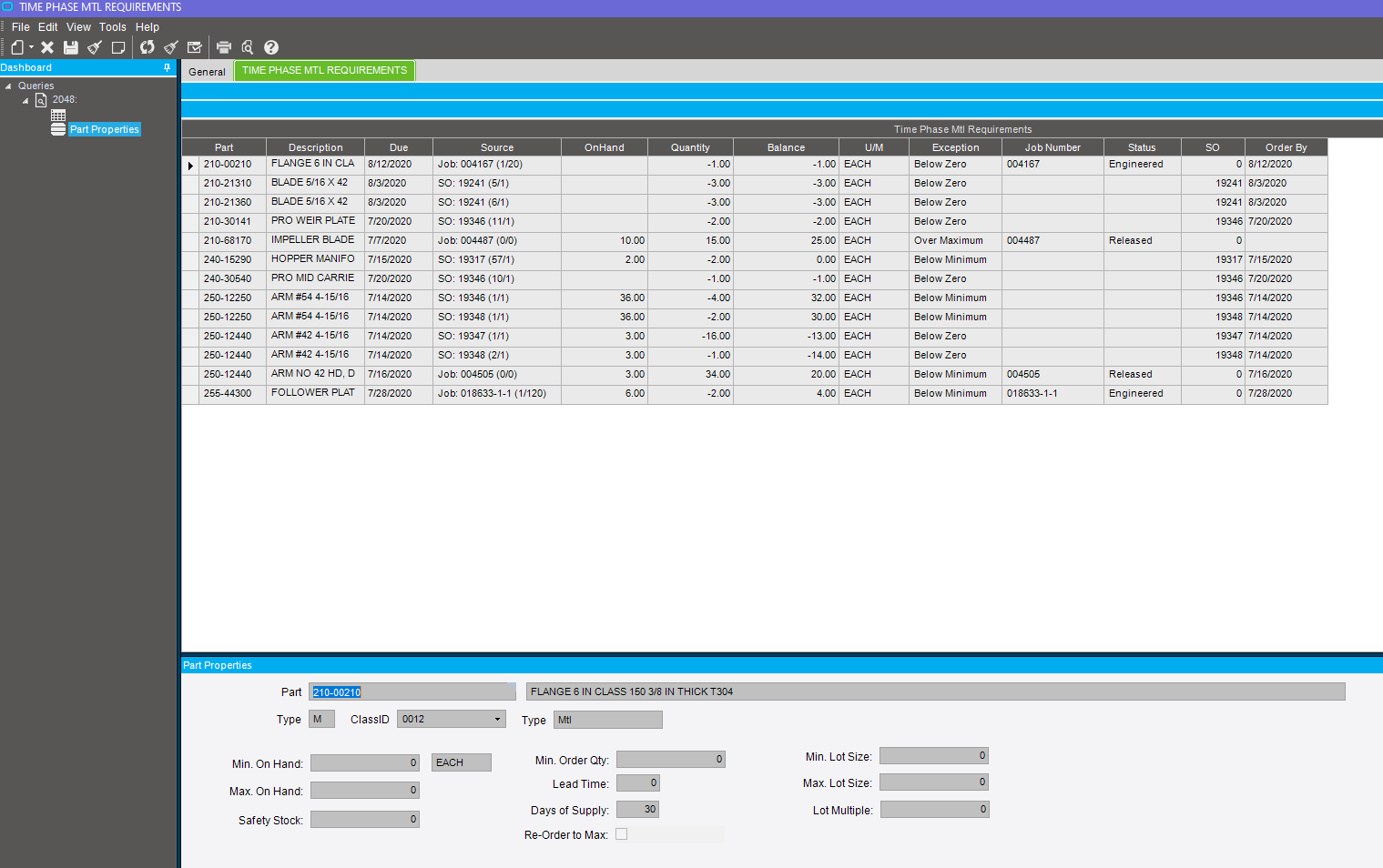

My task right now is to create the Time Phased Mtl. Requirements report into a dashboard so that we can filter out different values we do not want to see. Its suprising to see that Time Phase data is not more accessible. I have used the PartDtl table to do most of the dashboard and have used several calculated fields to get the different fields that are not provided (Source, Exception, Balance, Suggested Order Date, etc.) thanks to many folks on this forum.
One of the challenges is that exceptions that occur for On-Hand Quantity do not show because PartDtl does not give information for all parts but only the pending receipts/requirements. What would be the best way to get to this? Do I have to check all parts in our system to see if the OnHand < Minimum qty?
Also, I dont think I am doing the Suggested Order Date correctly. Currently, I am calculating the ReOrderPoint (safety + minimum). If RunningSum (Balance) < ReOrderPoint then DATEADD(day, -PartPlant.LeadTime, PartDtl.DueDate). The problem with this is that LeadTime is business days. How do I subtract production business days. How do I subtract business days from a date?
