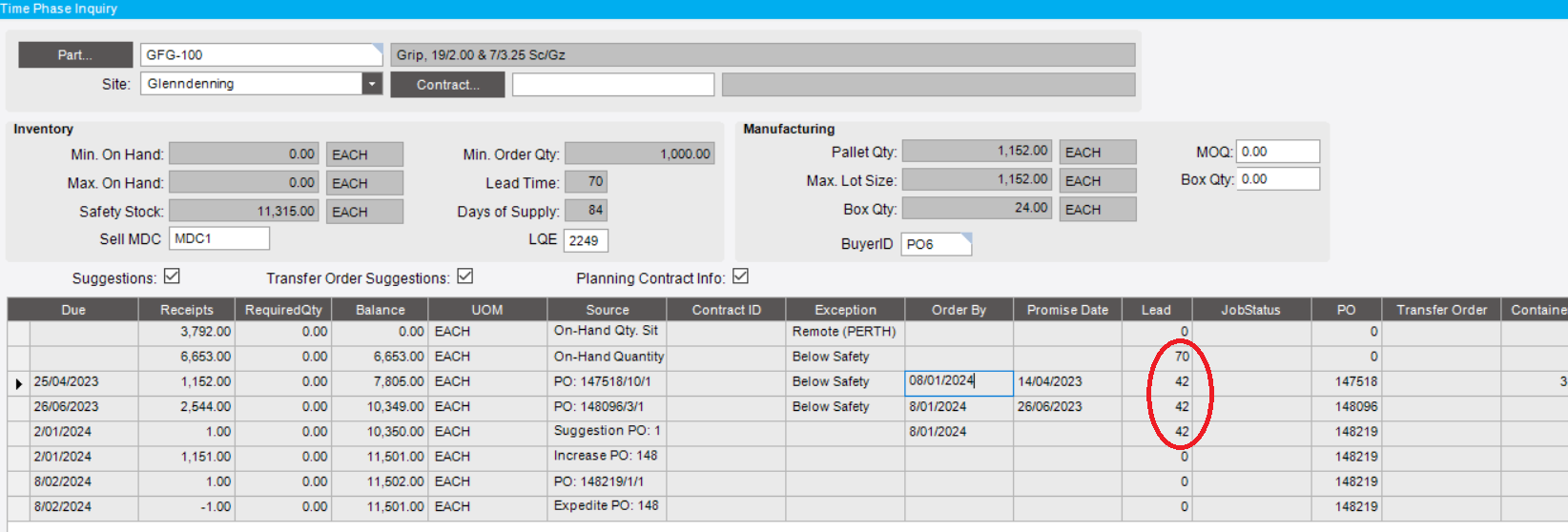

Can you please let me know how to calculate the Lead time for the Parts on this report?
Here in this case it shows two different lead time.
Part Lead Time - 70 hours.
How the other lead time 42 is calculated on this?

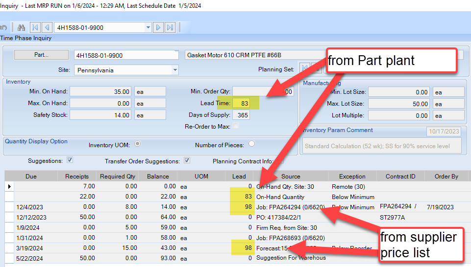

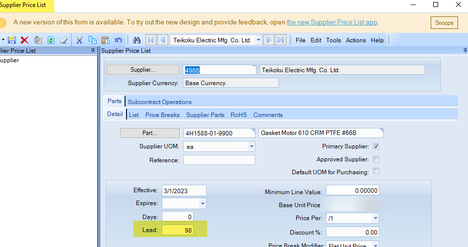

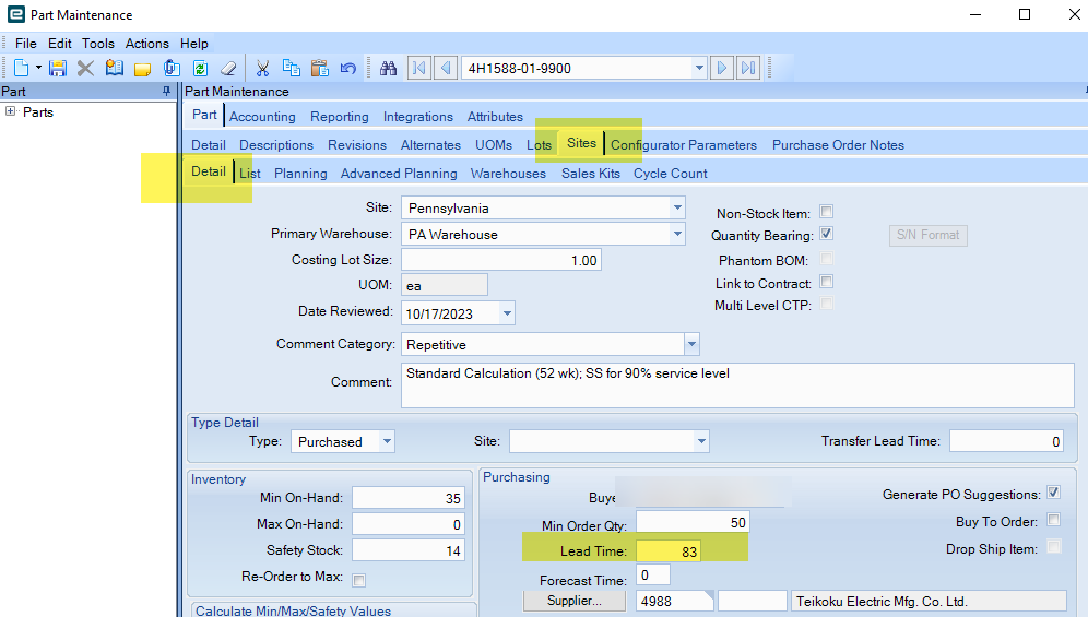

Hi Chandra,
Do you have supplier price list on the part? Where we have supplier price list on the part you’ll see that sometimes in timephase and then partplant value for lead time in timephase also. Note, sometimes urgent lead time can also be filled in on partplant and then there’s a 3rd lead time you might see as well ![]()
