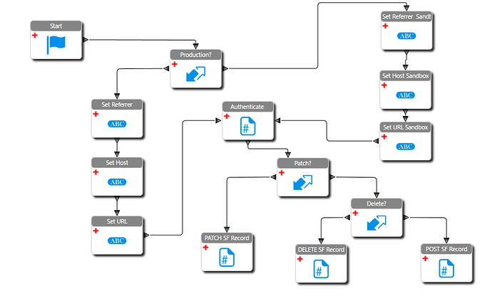

I built a Salesforce integration to sync data from Kinetic to Salesforce in a function library. I put all the REST Authentication and request functionality in a single function.
This function is called from various BPM’s that call it with 4 parameters provide all the information that is needed to create the desired request:
- Payload - the json body for the request
Action - the request method (POST, PATCH or DELETE). In my case, the function doesn’t do GET.
SFID - the unique identifier for the object record to be patched or deleted.
SFObject - the Salesforce Object to be affected.
The Authenticate widget uses RestSharp to get an access token.from Salesforce, then that token is used in the requests to patch, post or delete.

Nice job, @danvoss
