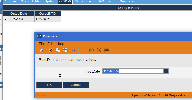

Interesting, does the problem affect inside BAQ editor or only when invoked via REST?
Edit: Well i dont guess it would\could

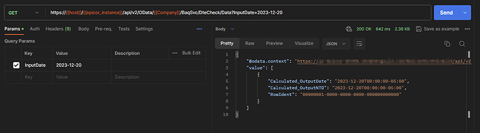

Only when invoked via REST, and only with V2! So not only is it wrong, it’s the worst kind of wrong where it’s inconsistent.

This is what I got back.

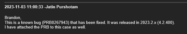

And I checked in our CR version, and it is fixed.
So that’s good news I guess. (doesn’t help us in this moment, but at least we can see light at the end of the tunnel)

More than that - OData v4, that is used in REST v2 BAQ, but not everywhere in REST v2 :smiling_imp:
It is coming from Microsoft part of the stack as ERP tables use DateTime data type only.
