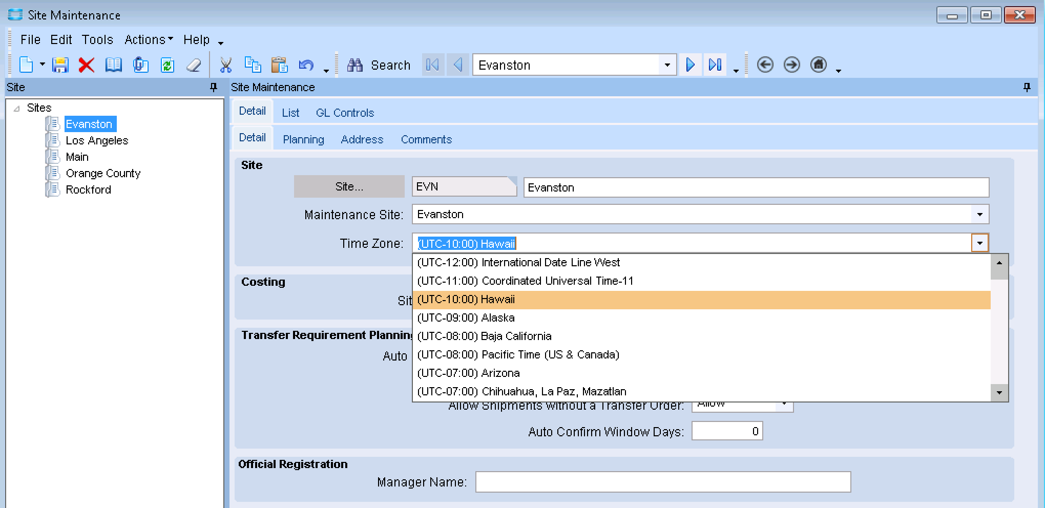

We have several companies located around the globe and I’d like to be able to calculate local time based on server time. Site Maintenance has a setting for time zone, which includes a UTC offset value…
…but what is stored on the Plant table is the TimeZoneID, which is only the text description…

The Time Zone value on both the Company and Plant contains the Windows Time Zone ID. From that, you can easily get the UTC offset and with that, the offset from the Company to the Plant. The original “Offset” value that was on Plant was problematic particularly if Company or Plant existed in a locale with different rules for Daylight Savings.

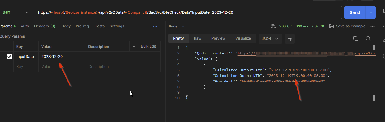

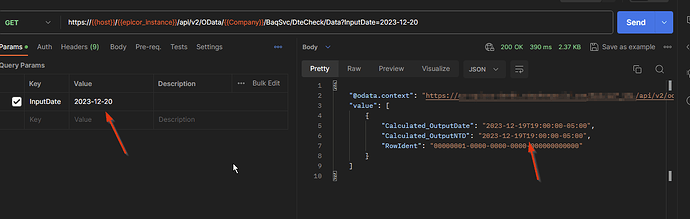

Since we’re necroposting… have any of you seen issues with sending in dates (with no time) and the date coming back out with a “Time zone” shifted date?

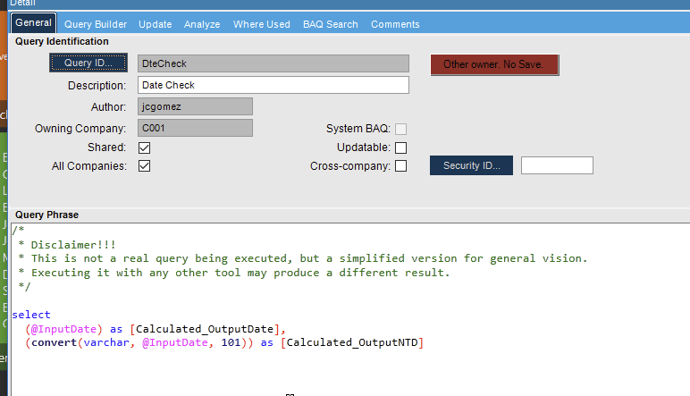

This BAQ is just taking a date parameter, and spitting it back out as a calculated field.

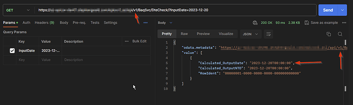

Even better, V1 doesn’t do the time zone hokey pokey. Kinetic still uses V1 in most of their screens (BAD EPICOR!) so you wouldn’t see this unless you are using the REST V2 api, which we are. And it’s causing stupid annoying problems that we don’t haven’t found a great way to fix.

Holy moley - so it just decides to shift your input date?

If you just put the input date param into a calc field (unless thats what you already did), does it shift that too?
That’s what this BAQ is.

We do. It doesn’t seem to follow those. It uses the server time zone, not the plant one.
I am all for hacky workarounds, I’ve built my hopes and dreams on them. You could possibly just pass a string and parse that bad boy yourself.
