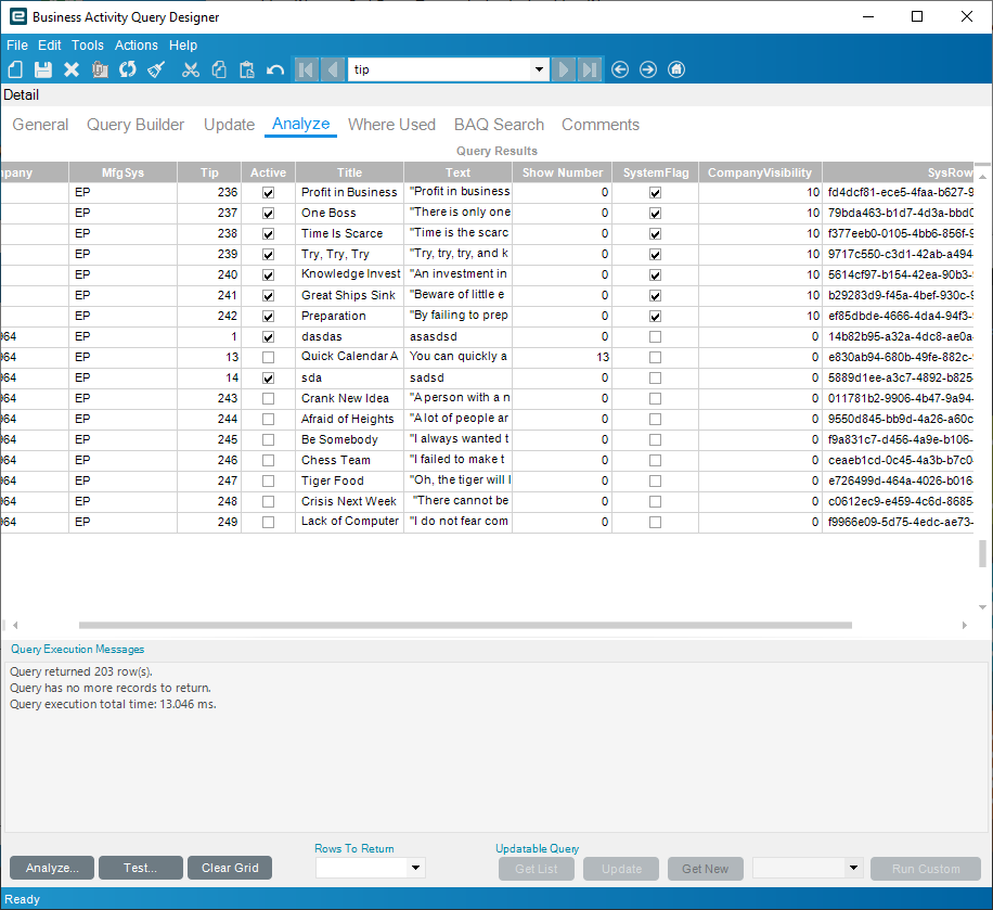

Since it let me update the records after spoofing it, you could probably do this with a ubaq and the bo. You could definitely do it with the Db context.
Awesome! Thanks, Kevin. We will take a look at this and let you know the outcome. I appreciate the help! I figured it was something that could be done.
Thanks again!
No go, at least with standard functionality, even after editing the advanced properties, UpdateExt didn’t like it. You could still modify the UBAQ BPM to use Update or the Db context though.

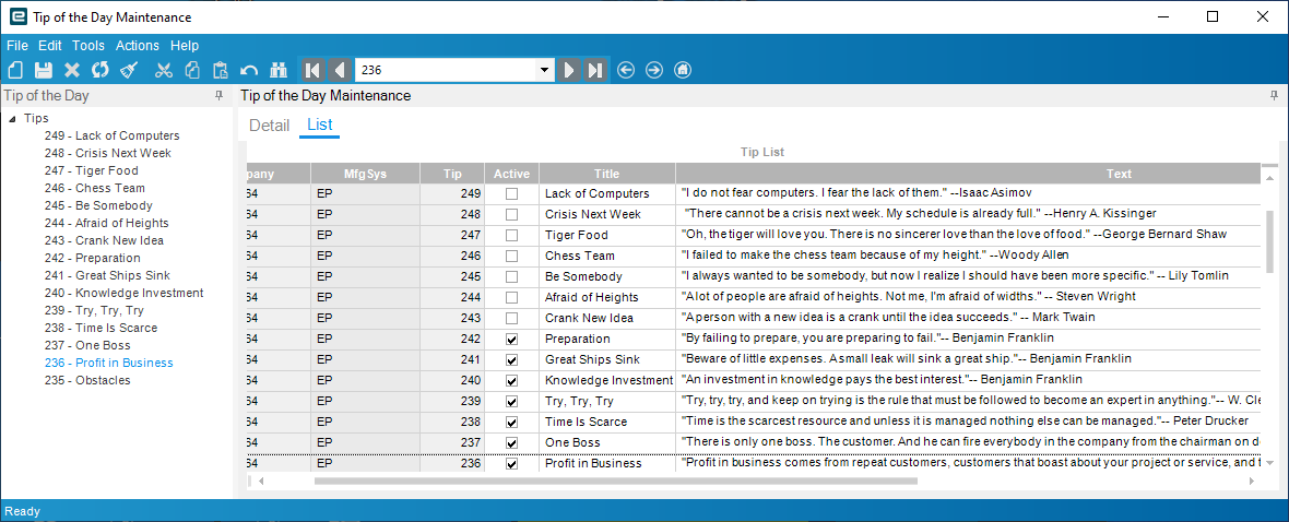

The little BPM snippet however seems like the easiest solution especially since you can just click the “List” tab:
Kevin,
That worked like a charm, thanks! I’m surprised the system doesn’t throw a fit over disabling a “SystemFlag” but in the context of “Tips of the Day” it is inconsequential…at least I think it is lol.
