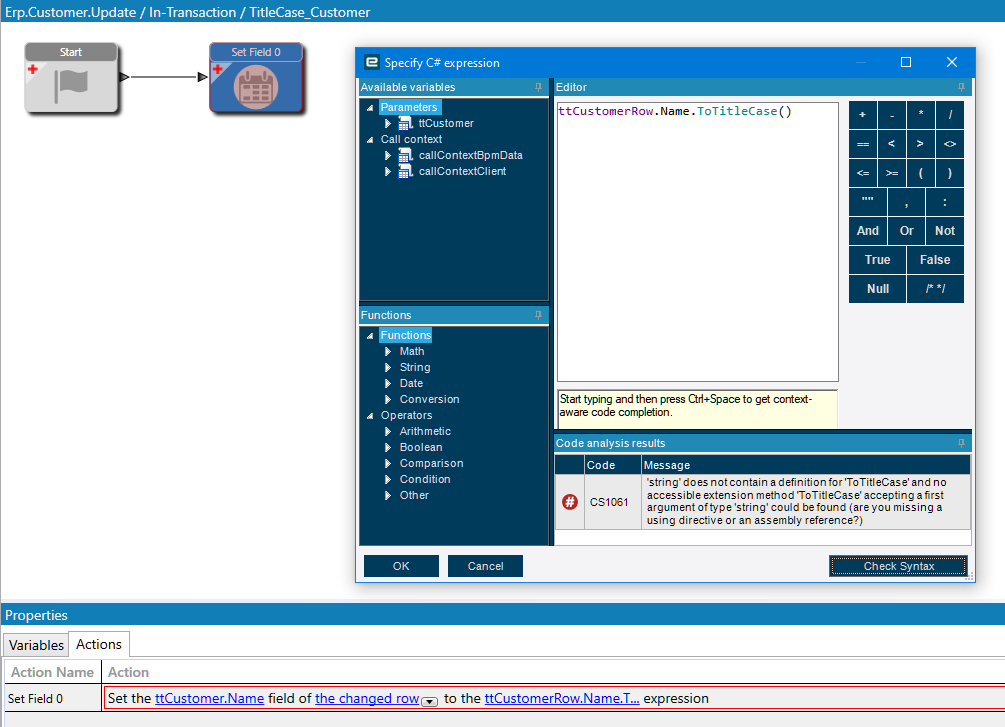

We’ve got the ToUpper and ToLower C# functions in Epicor, but ToTitleCase doesn’t seem to work in my data directive (trying to automatically change all Customer Names to Title Case)…

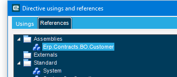

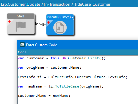

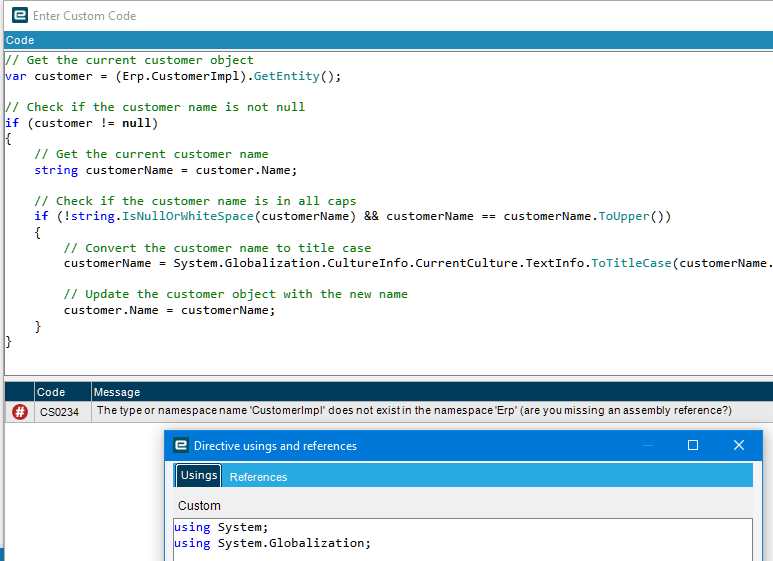

The StackOverflow article mentions using System.Globalization - Is that my issue? I added a CustomCode widget, set Using’s and pasted in the ChatGPT code (which doesn’t work, I’m thinking due to the setting the customer name variable).
Seems like this should be super simple for a real programmer (e.g. not me!).
ChatGPT suggestion, and then I added the Customer reference, not sure if it’s even needed:
Any advice is appreciated!

@markdamen - Thanks for the help! I don’t totally understand what I’m doing, but I got it to compile. It doesn’t capitalize the name when I do an update, though…
var custName = this.Db.Customer.Name;
TextInfo ti = CultureInfo.CurrentCulture.TextInfo;
var newName = ti.ToTitleCase(custName);
custName = newName;
I changed the syntax to match yours better, but it errored out since the Customer table didn’t have RowMod. I removed it the where clause, and it compiled but didn’t proper case the customer name.
