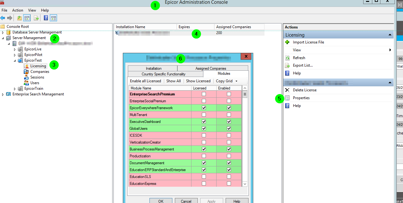

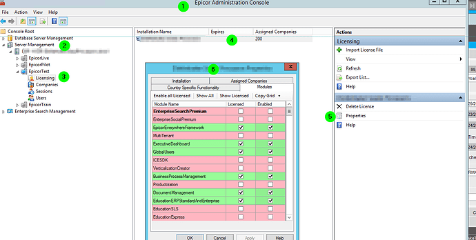

Do you have the AMM license?
Brad
Just to follow up on Brad’s question, you can check in the admin console which modules are licensed AND enabled:

Thank you so much. We used to have the license. But now we don’t have the AMM license.
