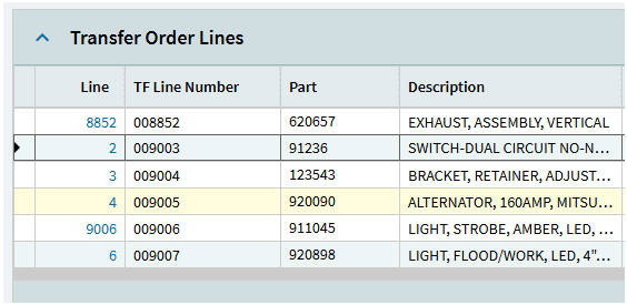

It starts out so simple, just a BAQ of transfer orders. Then I think, “Can a transfer be closed, voided, etc.?” And here is where I am at.
  1. I closed a line in the classic UI and it closed the whole order (which had 5 other open lines)
  2. I closed a line in the Kinetic UI, and it closed the line only.
    a. (This is the one thing that worked as expected. But…)
  3. There is no way in either UI to reopen a line.
  4. Made a uBAQ;
    a. It let me reopen the order
    b. It did not reopen any line
  5. Tried DMT for reopening lines
    a. There is no detail DMT specifically; you use the generic Transfer Order DMT with fields like TFOrdDtl#TFOrdLine. OK fine.
    b. Kept saying TFOrdDtl record not found
    c. Then I thought to try the TFLineNum (a string) instead of TFOrdLine (an integer). And it processed, but it did this to lines 1 and 5…
And I lost it at that point.
So… I suppose I will end with a question: does anyone ever close or reopen a transfer order line? Because, wow.
