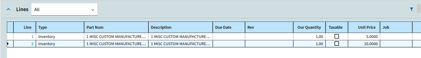

One of my estimators just put together a test PO -
Line 1 for qty 1 at $5 and line 2 is qty 1 for $10. and each has a misc charge of $50.
Here’s a screenshot of what the lines look like on the PO before generating a PDF copy.

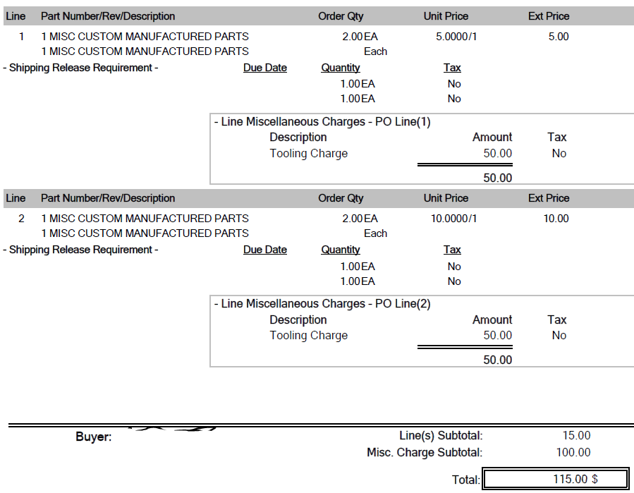

And here’s a screenshot of the PDF, where the PO is doubling the quantity on each line from 1 to 2.
As you will see, the total dollar amount is correct, but the quantities are not.
No, i haven’t seen this, i just tested this in 2023.2 and it works fine, I suggest that you do it again with tracing on, to see if any BPM’s are being called
@kristinak Is that the standard report and not a custom PO form? You can cause a lot of fun with the grouping in that form.
It appears our PO form has been customized so it totals properly at the bottom. I am no good at updating forms in Epicor :-1: so wouldn’t even know how to begin troubleshooting.
Same here. I know enough to only cause slight damage if I am careful and have outside help for the rest.
