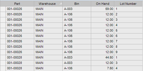

Here’s example results so far:
Notice I’m seeing two different parts, but a LOT of different records. These only appear in (1) Warehouse, but they show up in multiple bins, and we also lot track these and you’ll get a row based on lot number too… so many rows in the results.

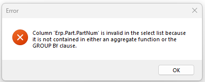

If you click the “Check Syntax” button on that calc field, you’ll get an error like this one:
There’s nothing wrong with the calculated field syntax… this is evaluating the entire query. In this case, we’re adding an aggregate column, so we need to “group” the rest of the query.

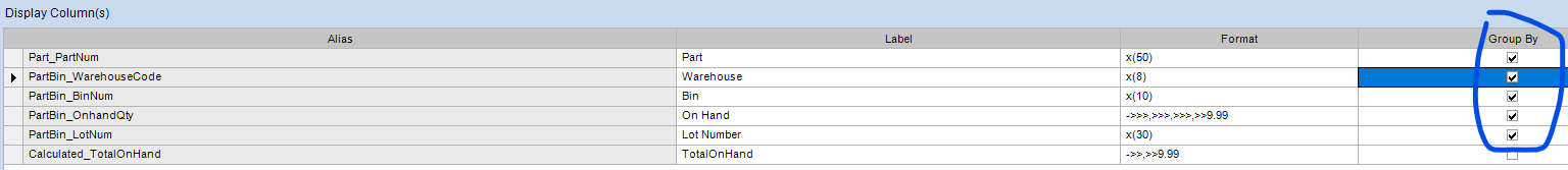

So, back on your display columns, add “Group By” to everything except your calculated field.

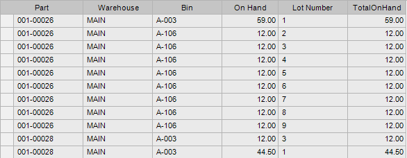

Now test your query:
I’m still getting all those rows!
This is because I’m asking the query to show those columns, like Lot Number.

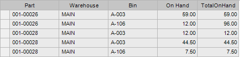

If I remove the Lot Number column and re-test… I now get this:
Note the first part in Bin A-106 shows on-hand (12) but TotalOnHand (96). It’s still splitting out the A-003 and A-106 bins. I have a total of 59 in Bin A-003 (regardless of lot number) and 96 in Bin A-106 (regardless of lot number).
