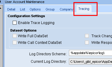

Tracing can be enabled “on-demand”, or can be configured to start automatically (on a user by user basis) when the user logs in.
The second one is in User Security.
