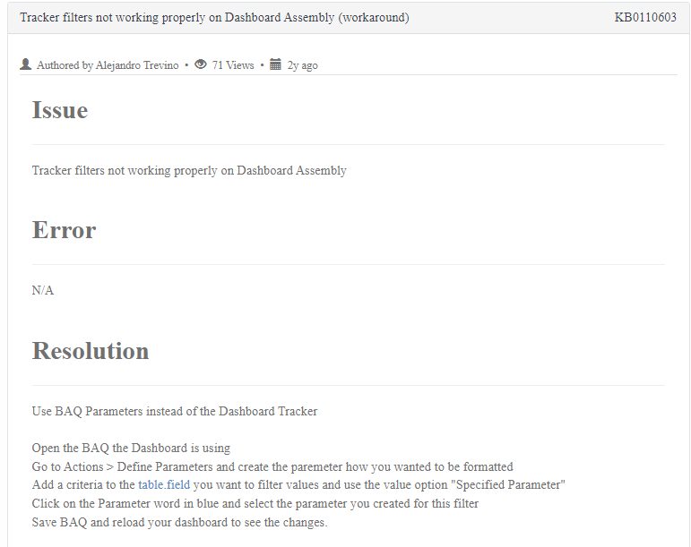

When using a combo to filter in the tracker view on a dashboard, it filters as expected in runtime but seems to ignore the filter when deployed as assembly. I see an Epicor KB article that says to just use BAQ parameters instead. That’s not really a solution as the BAQ parameter functionality is really annoying (constantly pops up). Plus we have a lot of different filters and they are all optional, so having them in the tracker view is ideal.

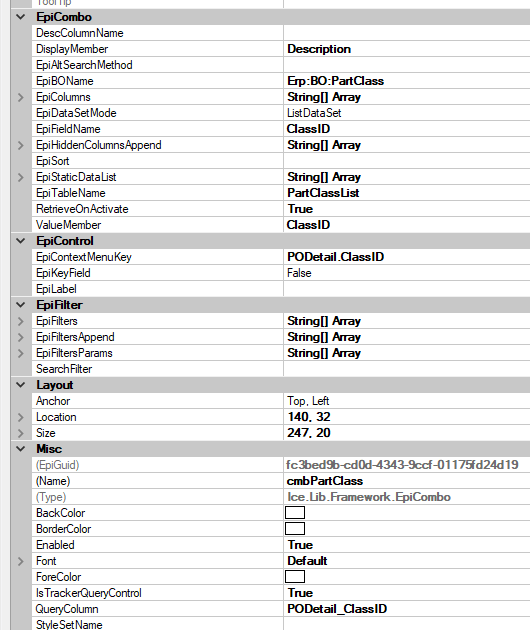

Yeah its not all filters that aren’t working, just some. Not sure why. Here is an example of one that doesn’t work in assembly:
So what does happen? What’s the KB?
Is that a combo you made, or one of the epimagic ones?
These dashboards predate me so I don’t know how they were created. I guess I could just try recreating the epicombos and see what happens, haven’t tried that yet.
