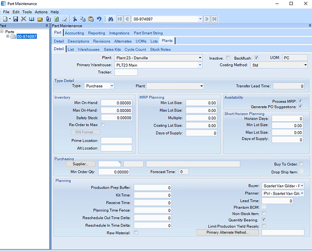

Have you already checked that Qty Bearing is set to true on the Site (Plant) sheet in part maintenance?
I’ve seen some confusion when Qty Bearing it is only set to true on the main detail sheet
but… set to false on the site sheet(s)?

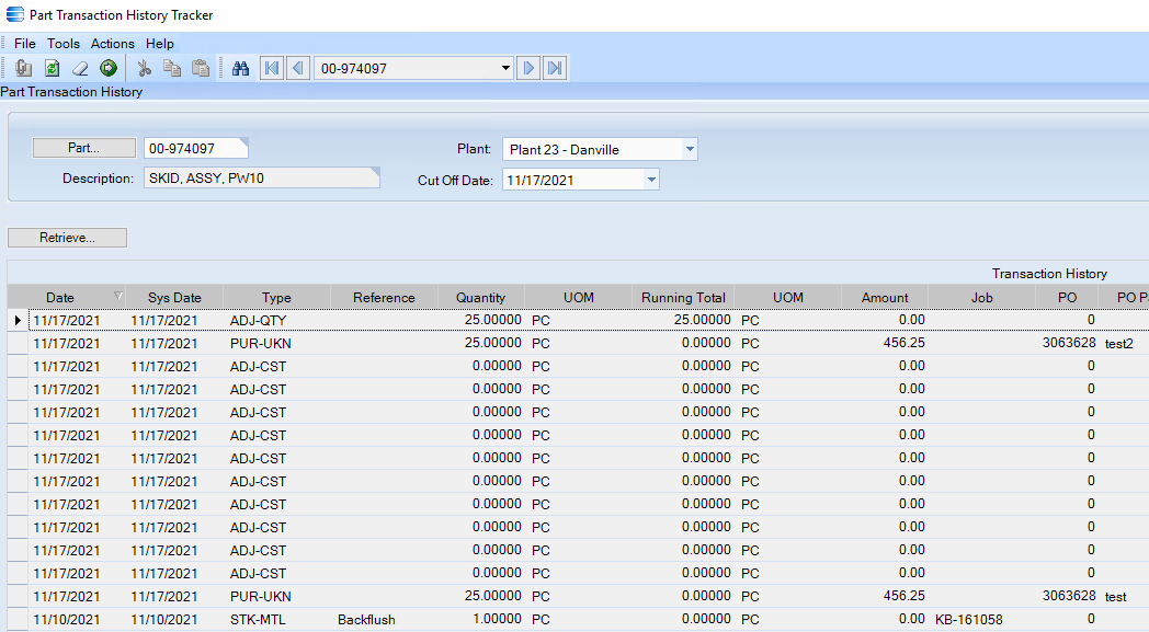

I double checked this as you suggested and the qty bearing box is checked in both places. I can manually add in a qty via an inventory adjustment and this qty is tracked. But it will not add in a quantity from a PO receipt, I am assuming because it creates a PUR-UKN transaction. I am looking for a way around this or a better way to set up MRO items maybe???

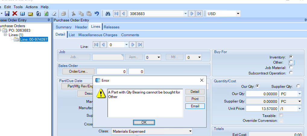

I created a new PO. Epicor made me assign an approved supplier before I could create one for this part number.
I am now getting this error message. I created one PO leaving the flag set as inventory. The account number on the release was correct for the expensed item so I thought this would work.
I received the PO and ran the Inv/WIP Reconciliation report. The amounts received posted to the raw material inventory account. I am not sure if this is a customization we have done here (to override the PO release account) or if it will always post this way with the inventory flag checked on the PO.
